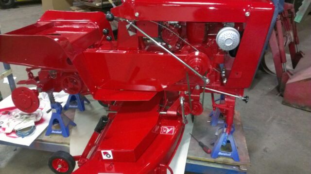

btm1970 97 #1 Posted January 17, 2013 im finishing up on my 1054 mower. the key switch up and down is on and it turned sideways is off. is this normal. or just turn the switch and turning the key left is on. the issue is, you cant take the key out when its off. its wired perfectly to the manual. any productive thoughts would help. 4 Share this post Link to post Share on other sites

smoreau 658 #4 Posted January 17, 2013 Sounds like the wrong ignition switch. Did you replace it? sounds like a mag switch that is open when turned on and closed with it off. 1 Share this post Link to post Share on other sites
Martin 2,134 #5 Posted January 17, 2013 (edited) yep, totally agree with scott. i had the same issue when i bought my 1054. replaced with a battery ignition switch and problem fixed. one other thing was i had a external resistor coil on mine (with no resistor) and if the key was removed (ignition on) that coil got very very hot....... replace the switch and your problems will be over, just make sure you get a switch for a battery ignition...... that 1054 of yours looks very nice. Edited January 17, 2013 by Martin 1 Share this post Link to post Share on other sites
btm1970 97 #6 Posted January 17, 2013 thanks, it came with a light switch as an on and off. my dad picked up the new key switch up for me. i was just a standard two pole key switch. yes, with the key removed the coil will fry. will get the battery ignition. thanks again 1 Share this post Link to post Share on other sites

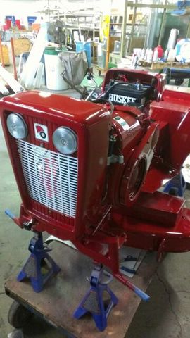

btm1970 97 #9 Posted January 18, 2013 855ownerjoel, be ready for lots of pit filling and wet sanding. installed the grill this afternoon. Share this post Link to post Share on other sites
