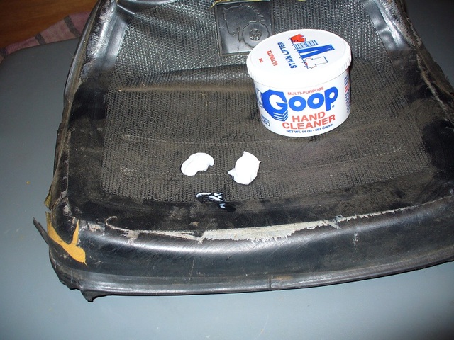

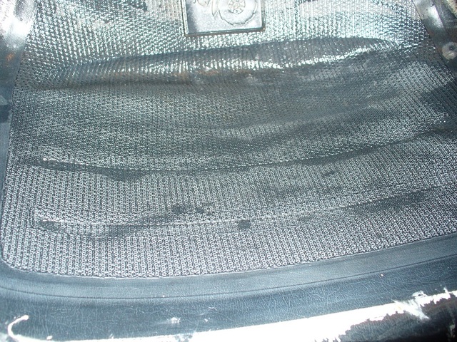

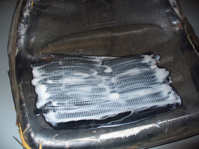

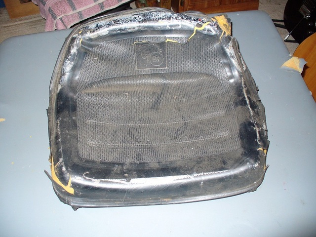

TT-(Moderator) 1,185 #13 Posted January 19, 2013 FAIL! The guinea pig is an officially-embossed seat cover from an early 80's Work Horse LT Even warmed up, it's quite brittle and stiff. Although the Goop "trick" I read about was technically for vinyl automotive seats, I figured it was worth a shot on this seat cover. Here's the seat: The Goop seagull flew over Worked in with my fingers first, then an old toothbrush: Nothing really changed in the feel of the cover, but it did remove the surface dirt: Once that spot dried, I applied some mink oil. It made it a little better looking, but didn't penetrate the cover or soften it in any way. I applied another round of Goop and left it there for approximately 16 hours. It turned into a clear liquid and once again had no effect of the hard seat cover. My conclusion is that auto upholstery is a more porous "fabric" vs. the plastic-like vacuum-formed material used on this type of molded seat. The Goop might work on the sewn covers found on the earlier tractors, but it did absolutely nothing on this cover. 2 Share this post Link to post Share on other sites
