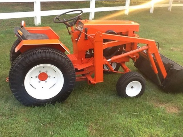

brandonozz 168 #1 Posted January 12, 2013 I was curious if anyone knows anything about Case garden tractors and what type of FEL's they use. I am goning to be going to look at one and was wondering how hard it would be to mount onto my C160. I thought that I would need to build a subframe to get it mounted. Any thoughts? Thanks for your experiences! Share this post Link to post Share on other sites
wallfish 20,671 #2 Posted January 12, 2013 The garden tractor FELs are basically the same except for the sub frame to mount it. I think Case tractors used a Johnson loader on their machines. So my guess without seeing it is, yes you will need to build a sub frame and possibly get some new hoses for the pump if they are not long enough. Share this post Link to post Share on other sites

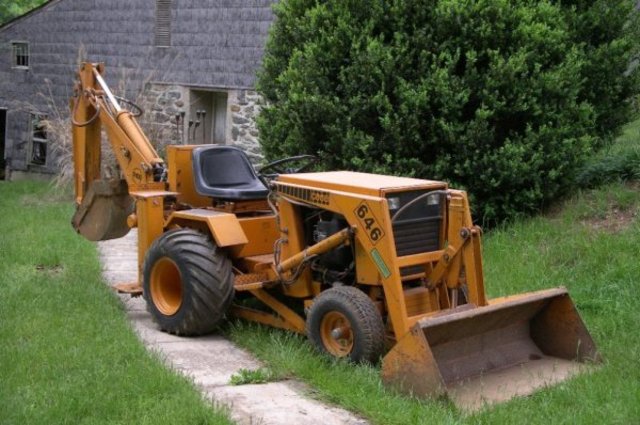

Kelly 1,038 #3 Posted January 12, 2013 Most Case factory loaders are part of the tractor, not a add on, google 646, and you will see the machines I'm talking about, they made other models but same basic tractor different engines, I'm sure there are aftermarket loaders built for them also. 1 Share this post Link to post Share on other sites
wallfish 20,671 #4 Posted January 12, 2013 I was thinking of the smaller tractors like a 444 Share this post Link to post Share on other sites
brandonozz 168 #5 Posted January 13, 2013 Thanks for the replies. The loader is an "add on" similar to the 444 and not built into the tractor. Kelly, I did look at some pics of those 646s'. Man those look like tough little tractors and they are well talked about on the forums. Share this post Link to post Share on other sites

Kelly 1,038 #8 Posted January 14, 2013 This is a small tractor, pretty much the same thing as the 444. Share this post Link to post Share on other sites
