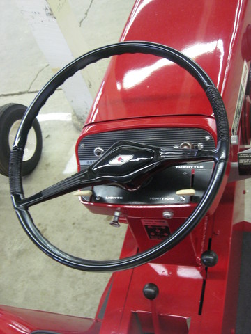

Martin 2,134 #14 Posted January 14, 2013 from that partial serial number and the ross steering it looks like you have a 953. from you original pic i zoomed in on the steering wheel and it wasnt a 1054 shaped one, looked like the 953 with the center section missing. i think from the steering wheel, ross steering box and that serial number its a sure bet its a 953.... im not sure when exactly they changed to the later 1054 style steering wheel. the later wheel continued into 1967. do you have the steering wheel center section as well? if not its going to be a hard item to get ahold of. these can be converted to later style steering though if needed. like justin said a belt guard can be made up fairly easily, its not a complicated piece to bend up. the tie rods are easy to fabricate too, used ones are usually worn beyond repair anyway. lots of members on here (myself included) have fabricated up new tierods for these models. check out my 1054 build in my sig, i think i had a few pics of what i did with mine..... you didnt mention whether you had a hood or not? Share this post Link to post Share on other sites

Martin 2,134 #16 Posted January 14, 2013 (edited) i just realized that we may be talking about two different tractors here. are you saying you bought the tractor in the pic above or a completely different one? sometimes it gets confusing when somebody other than the op starts asking questions about their tractor in the same thread, i guess thats my fault for not paying attention..... what i was saying about the center section was for the early steering wheel in the pic above, it doesnt look like its there. its a totally different wheel than the 1054 style wheel. heres one, not my picture or tractor..... Edited January 14, 2013 by Martin Share this post Link to post Share on other sites
gratefulydeadman 25 #17 Posted January 14, 2013 i now own the tractor in the pic above. sorry. i will post better pics tomorrow Share this post Link to post Share on other sites
Martin 2,134 #18 Posted January 14, 2013 cool, i guess it all worked out ok then. do you remember if the wheel is like in the pic above? Share this post Link to post Share on other sites
gratefulydeadman 25 #19 Posted January 14, 2013 it doesnt have the little grip things on it .. the entire circumference is smooth. except for the small bumps on the underside of it. and doesnt have the centerpiece either Share this post Link to post Share on other sites
