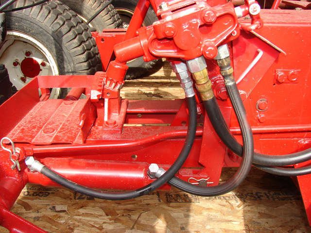

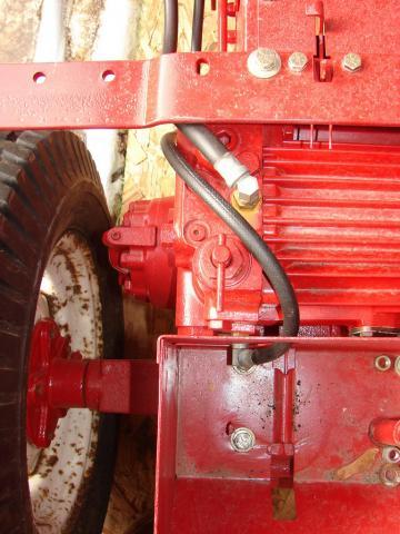

B-8074
I'm not sure if this is the set up you have, but here is two pics of mine.
post-2569-0-23700900-1357310008_thumb.jp
post-2569-0-47916700-1357310020_thumb.jp

the hydraulic rams on these older ones are not rebuild able right? if so are the newer ones the close enough to put one on the tractor? mine appears to leak haven't got the control rebuilt to test yet
Kelly
you said you didn't see any problems that could cause the issue, but the bad O rings are the issue, they are letting oil pass them so the lift will not work properly, some of the old lift cyl. are rebuildable you have to look at the end the rod comes out of, see if there is a large snap ring holding the end cap in, if so you can rebuild it, some newer cyl. will fit, others you have to watch where the lines go in to the cyl. they are not in the same position, looking from the end, see where the foot rest bar goes through, some the lines are straight up others are off to one side, and may interfere with them fitting.

B-8074
The older lift cylinders didn't have a snap ring. They used a retaining ring. It's hard to see it unless you take the cylinder off. Then you have to push down on the end of the cylinder to reveal the retaining ring. It looks like heavy round wire.
