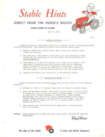

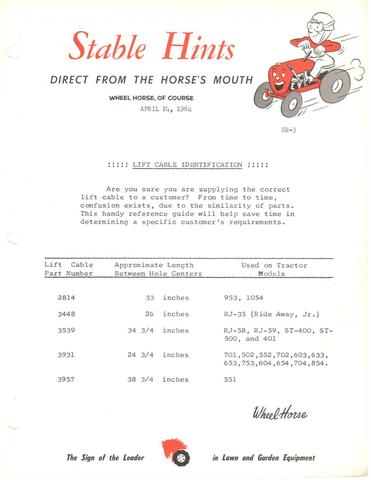

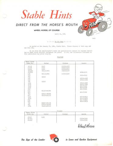

wh5208speed 677 #1 Posted January 1, 2013 Here is three really neat communications from Wheel Horse to it's dealers back in 1964. Thought you might enjoy. Thad (Ohio) 5 Share this post Link to post Share on other sites
