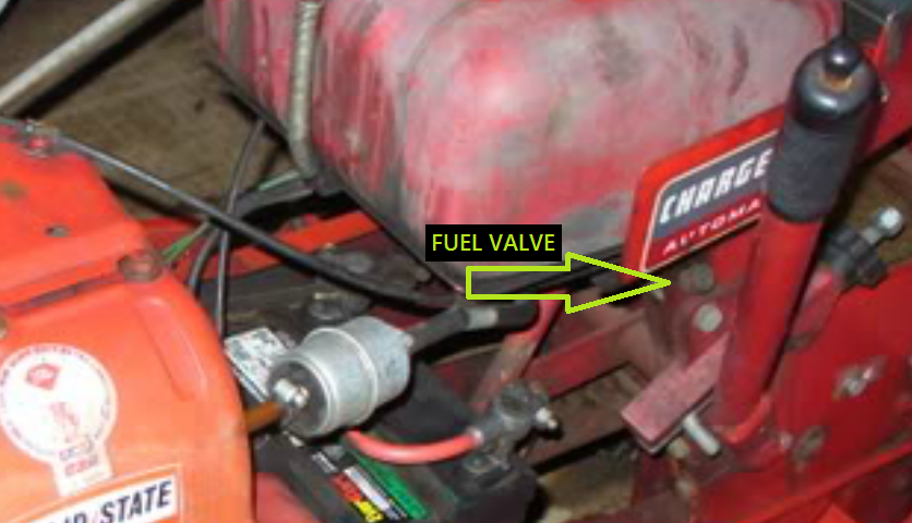

Sodaking27 1,260 #1 Posted January 1, 2013 My Charger 12 has started leaking at the gas shutoff valve. Is that part still available for replacement? What do you guys do to correct the issue? Share this post Link to post Share on other sites

Sodaking27 1,260 #3 Posted January 1, 2013 Martin, It has the plastic tank. Short piece of hose from tank to valve. The valve is bolted to the left side dash riser. Share this post Link to post Share on other sites

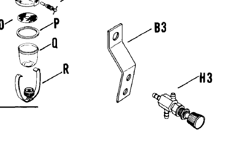

TT-(Moderator) 1,170 #11 Posted January 1, 2013 I've seen these valves at show displays often so some are still out there. Tank mounted valves are readily available, but the panel mount valves are scarce. They were undoubtedly sourced from Kohler and I can find them in the parts drawing - but haven't come up with a part number (yet): Share this post Link to post Share on other sites
