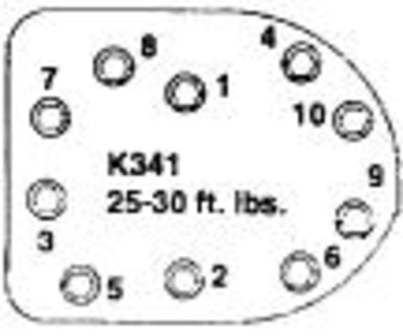

joel_400 59 #2 Posted January 1, 2013 Look for k341 on the pto end of the block, ten head bolts, and bigger exhaust port...1 1/4 pipe instead of 1 inch. Joel Share this post Link to post Share on other sites
Martin 2,134 #3 Posted January 1, 2013 (edited) well the most noticable difference between the 16 and the 10-14 hp kohlers is the head bolt pattern.... the 16hp or k341 has an extra head bolt.... so if you only have 9 bolts holding on the head you know for sure that you dont have a 16 hp engine. i think most if not all have larger exhaust port as well..... looks like you beat me to it joel Edited January 1, 2013 by Martin Share this post Link to post Share on other sites
Wishin4a416 2,604 #4 Posted January 1, 2013 I cant answer your question on how to tell the 10-14 horse motors but I did learn here that the 16 Horse has 10 Head bolts rather than 9 like the others. When I picked up a 160 last Friday, thats the first thing I checked was for 10 head bolts. Im sure someone here will know. The only way I would know would be by pulling the head and measuring the bore. Share this post Link to post Share on other sites
Wheel-N-It 2,978 #5 Posted January 1, 2013 You are good to go on the identification Jack. If you have 10 head bolts then its a 16 for sure. Two things I would check are the points gap, make sure the gap is set at .020 This basically ensures the timing is correct. Pull the carb and compare it against one fron a 12 or 14hp Kohler. The 16hp carb is a bit larger to give the gas necessary to produce 16hp. The K341 will run fine with a smaller carb but it will not produce maximum horsepower. This may not be the problem but if if your engine has good compression, then these two things should be verified before you start taking the engine apart. Also don't forget to check the air filter! Share this post Link to post Share on other sites
3609horse 27 #6 Posted January 1, 2013 Thank you all for the advice. I went out and checked and only have 9 head bolts. Now I know its not a 16 kinda makes me feel better knowing its doing all it can do just not enough hp. Again thanks to all that responded. Now it will be a plow tractor and let the blower go to a larger hp tractor. Hope everybody had a safe holiday, thanks. Gene... Share this post Link to post Share on other sites
