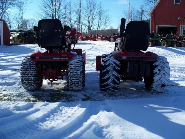

brandonozz 168 #17 Posted January 1, 2013 The 26" tires look great but can you tell a noticable difference with regards to traction. Either when pushing a blade in the snow or more importantly pulling a turn plow or disc in the dirt? I'm curious if the larger tires / foot print would help a bit preventing wheel spin. Anyone have any experience? Share this post Link to post Share on other sites
Kelly 1,028 #18 Posted January 1, 2013 I didn't have a tractor with 23x8.5x12 tires handy but this is 2 520's one with 26x12x12 Tru Powers and one with 23x10.5x12 with chains, these are the square corner Carlisle turf savers, and as I said the one with 26's on it I raised the fender 3/4" The big tires dig good unless on hard packed snow or ice. most hard packed snow it will dig through it, but I have 200lbs of weight hanging off the back. 1 Share this post Link to post Share on other sites
