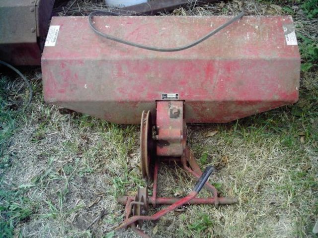

855ownerJoel 32 #1 Posted December 30, 2012 Looking at this RT 366 tiller tomorrow. What is it worth? Thinking of offering $150.00 is that crazy? Would really like to add a tiller to my work equipment. Thought if I got it now I could refurbish before spring time hits. I have seen soe working on internet and they seem to be good workers. Want to use it to work up garden and food plots for the deer. Any thoughts would be great! Share this post Link to post Share on other sites
can whlvr 994 #2 Posted December 30, 2012 as long as it works and every thing is there,thats a fair price,a good deal where i live but we dont have as much stuff as some places Share this post Link to post Share on other sites
sorekiwi 761 #3 Posted December 31, 2012 I paid a little more than that for mine (also a 366). The very early tillers are a little different than the later ones in the belt/idler arrangement and in the length of the hitch bracket on the front. I ended up adapting a NOS twin belt drive arrangement to mine, and had to change the front subframe to fit it to my 1267. Let me know if you want details. Share this post Link to post Share on other sites
855ownerJoel 32 #4 Posted December 31, 2012 Looks a little dangerous with belt location, do you use a guard for the belt? I paid a little more than that for mine (also a 366). The very early tillers are a little different than the later ones in the belt/idler arrangement and in the length of the hitch bracket on the front. I ended up adapting a NOS twin belt drive arrangement to mine, and had to change the front subframe to fit it to my 1267. Let me know if you want details. Share this post Link to post Share on other sites
sorekiwi 761 #5 Posted December 31, 2012 Looks a little dangerous with belt location, do you use a guard for the belt? No I dont have a guard. The manual shows one, but I havent seen one in real life. I may make one some day, but its not high on my priority list. The footrest on this tractor is positioned so your leg stays in one place, as opposed to a tractor with footboards where you can move your foot/leg around. There is a couple of inch's of clearance between my leg and the belt, I'm not too concerned about it. If I hurt myself, I'm not going to be running around looking to sue someone (the main reason there is gaurds on everything these days). Share this post Link to post Share on other sites
brandonozz 168 #6 Posted December 31, 2012 I think I had to give $300 for mine and the guy wouldn't budge a bit. About a year later I saw one on the local CL for $100 - just my luck! They work great on gardens but be prepared to spend a lot of time if your putting in food plots - expecially if it's the first time you break the ground. Can't go too fast or the tiller won't stay deep. Even had one time the belt started slipping due to trying to go too fast on hard virgin pasture ground. Share this post Link to post Share on other sites
Kelly 1,038 #7 Posted December 31, 2012 The early tillers don't bring as much as the newer ones do, be sure the bearings are good, I see the mid idler pulleys and a belt, but no axle bracket, you will need the early bracket not the later one it will not fit, and what tractor will you be running it with?? Share this post Link to post Share on other sites
SousaKerry 503 #8 Posted December 31, 2012 Wow 855owner Joel that thing looks like an accident waiting to happen and hungry for a pant leg too I think I would start riding it side saddle Share this post Link to post Share on other sites
855ownerJoel 32 #9 Posted January 2, 2013 The early tillers don't bring as much as the newer ones do, be sure the bearings are good, I see the mid idler pulleys and a belt, but no axle bracket, you will need the early bracket not the later one it will not fit, and what tractor will you be running it with?? I was hoping to put it on my B80 or my 8. I have several options and growing. Share this post Link to post Share on other sites

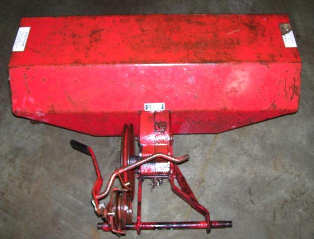

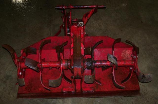

855ownerJoel 32 #12 Posted January 6, 2013 Here are some pics. Really checks out great, bearings and gear box are tight and roll great. Little seal leaking but will replace them and then get ready for spring. Share this post Link to post Share on other sites
can whlvr 994 #13 Posted January 6, 2013 good lookin for 150,as i said they work great Share this post Link to post Share on other sites
Kelly 1,038 #14 Posted January 6, 2013 Did you get the rear axle bracket?? that tiller uses the old style bracket, the new one will not fit it, not sure on that tiller, but some use a rear bracket that has a idler pulley mounted on it just for the tiller. Share this post Link to post Share on other sites
855ownerJoel 32 #15 Posted January 6, 2013 I have one and checked it today, looks to fit. When I get some time (and room in the shop) I will hook it up and test run before spring gets here. Share this post Link to post Share on other sites
