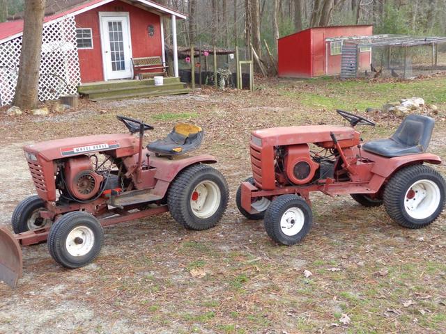

jay in nc 210 #1 Posted December 29, 2012 my goal this year is to get as many of my tractors running & opperating as well as can be. my short term goal is to get all 4 of the tecky powered machines working. i'm half way there! the 1969 raider 9 i bought at Pittsburgh-Parts-Arama in 1994 & was in regular use untill 2002 when somthing went wrong with the trany. KPfrom NC.noticed the hub was moving but not the axle,so i replaced the hub & woodruff key flushed it out & installed new axle seals, shift boot &fresh 85-140 gear lube. i also fixed the battery box and put a new throttle cable, gas lines & fuel filter on it. I soaked the carb overnight & blew it out. it runs super! great at pushing leaves into the pile. the other one is a 1971 workhorse 800 that i bought last year from a RS. member he was restoring it when he had a mc. wreck & lost his leg. well the poor workhorse sat right where it was for several years till i steped in & saved it.this one needed a new carb from the late WHEELHORSEJUNKY. new throtle & choke cables, the trany flushed & new seals & boot & gearlube & 1 valve stem on 1 rear tire. then i welded the seat pan & installed a better seat. boy does it run well! now i only have to install the S.G. on the nos. hh120 on the 1967 1077 & put a tube & do a carb clean on the 1967 lawn ranger & all my tecumpseh powered machines will be work ready! so fellow members what are your WH. goals for 2013 ? HAPPY NEW YEAR JAY IN NC 5 Share this post Link to post Share on other sites

Wishin4a416 2,594 #10 Posted December 29, 2012 You have some real nice tractors there. 1 Share this post Link to post Share on other sites
