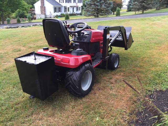

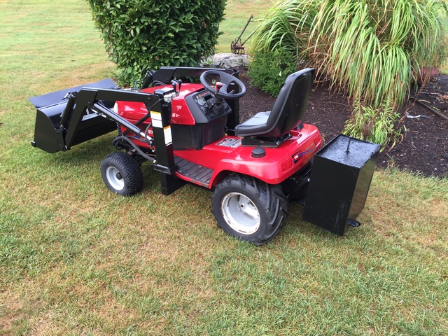

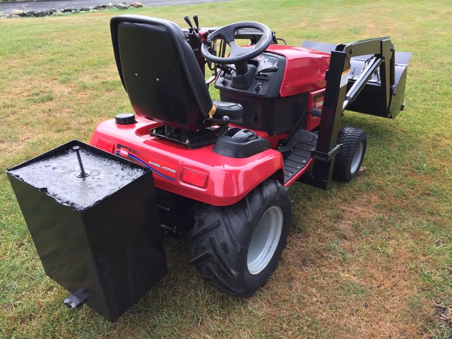

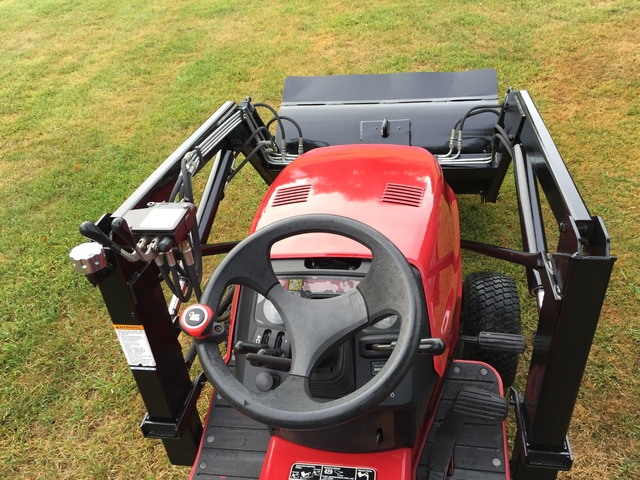

stevebo-(Moderator) 8,590 #55 Posted September 12, 2015 Here is the one I picked up this week. Buffed out nice and painted the loader. 8 Share this post Link to post Share on other sites

stevebo-(Moderator) 8,590 #59 Posted September 13, 2015 Mine is a keeper. Share this post Link to post Share on other sites

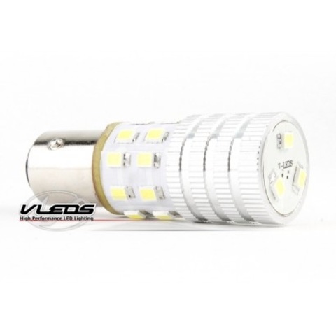

PeacemakerJack 10,803 #64 Posted September 18, 2015 Guys,I purchased these from VLEDS.com. They have HIGH QUALITY LED light bulbs. There are plenty of cheap brands out there for $10. If that is what you want to do, go for it but you won't likely be satisfied with the results. Light Emitting Diodes are a newer form of lighting but they are taking the industry by storm. Years ago they were so expensive and the light for the dollar wasn't really worth it. However, as incandescent bulbs are being phased out LED's are getting a lot of focused attention and the results are amazing. They operate basically cool to the touch and the output of light vs the electricity that they use is truly amazing. The set I bought has 21 LED's that are 0.5Watt draw each. My quick math says that is drawing less than 11 watts per bulb yet mine cast 510 Lumens. A typical incandescent 1156 casts about 350 Lumens. Glenn mentioned the 50W halogens, they would technically have a higher lumen output but at a cost. I'd be really worried that the heat would melt the lens and the housing even. Plus, you could run nearly 10 of the LED's for the amount of draw on your system. Having said that---these things aren't cheap. A set is $50 but they have a projected lifespan of 5000 hours. If that is even half correct, these are the last headlights that I would need to buy. Also, since I'm the test case already. Please let me use them a few times at night and report about it before any of you buy some. I'll be sure to report back to you on my thoughts once I've tried them in a "real world" environment. What they do in the shop is one thing, what they do in the yard could be another although I hope not! 1 Share this post Link to post Share on other sites

PeacemakerJack 10,803 #70 Posted September 18, 2015 Glenn,You are right when you say it can be confusing!!! The bulbs I purchased have 18 LEDs around the barrel and three facing forward off the end. The ones around the barrel seem to make great use of the reflective housing. The following is the exact description found on the website of the bulbs I purchased... 5K WHITE 21 LED PARKING BACKUP LIGHT 1156 2056 510LM | 1 PAIR ...and this is what they look like...I hope this helps. By next weekend I should be able to give a review... 2 Share this post Link to post Share on other sites
