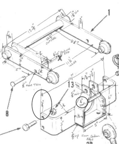

Kelly 1,038 #1 Posted December 26, 2012 how thick is the mount for the center link on the 3 point for a C-195? I'm going to pick up some steel tomorrow. Share this post Link to post Share on other sites
jdog_kustoms 82 #2 Posted December 26, 2012 i can look tommarrow after work if that helps you but i wanta say 3/16 to 1/4 Share this post Link to post Share on other sites
stevebo-(Moderator) 8,742 #3 Posted December 26, 2012 Kelly, I believe that Brian posted a drawing of his about a year ago. It is very detailed. Share this post Link to post Share on other sites
Kelly 1,038 #4 Posted December 26, 2012 I have the drawing, I don't see the thickness, I'm leaning to 1/4" or thicker. Share this post Link to post Share on other sites
stevebo-(Moderator) 8,742 #5 Posted December 26, 2012 I am not sure however I would think 3/8 min. Share this post Link to post Share on other sites
baerpath 517 #6 Posted December 26, 2012 Checked mine there 1/4 Share this post Link to post Share on other sites
fireman 1,022 #7 Posted December 26, 2012 (edited) It's says right on the drawing 1/4" Stock. The main piece that it's welded to is 3/8". Edited December 26, 2012 by fireman Share this post Link to post Share on other sites
Kelly 1,038 #8 Posted December 26, 2012 Thanks I seen the upright part was 1/4" but was not 100% sure if the 3/8" ment the hole or the plate size, I kinda planned on the 3/8" if I didn't get a for sure answer. Share this post Link to post Share on other sites
buckrancher 2,697 #9 Posted December 26, 2012 yes the main U shaped part is 3/8" and the weld on piece for the upper link is made from 1/4" stock Brian Share this post Link to post Share on other sites
Kelly 1,038 #10 Posted December 26, 2012 thank you, I never made it to town today with the weather and doing a few things here, so tomorrow I'll pick up some steel, to fab up a mount. Share this post Link to post Share on other sites
