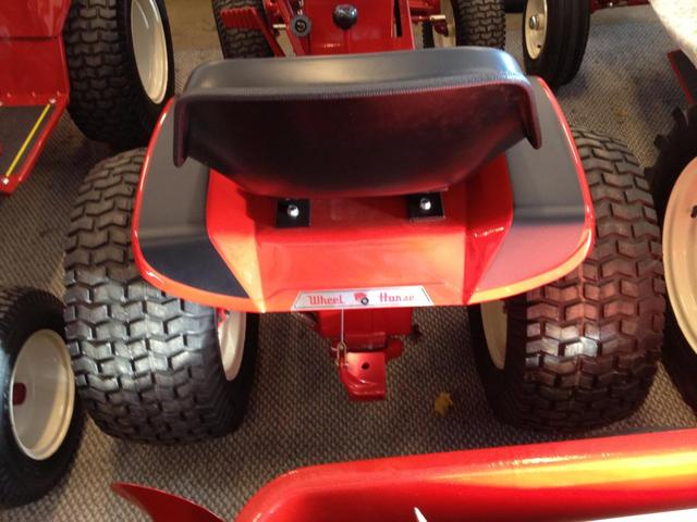

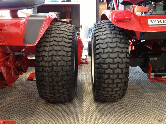

Martin 2,134 #4 Posted December 25, 2012 (edited) i used 23 x 9.50-12's on the rear of my 1057 build. heres a pic.... heres my 1057 (with the 9.50's) on the left next to my c125 on the right (with oem 1980 turf savers in 8.50's) the width is most noticeable at the sidewall area, the wider ones bulge considerably more. the tread blocks are wider too..... these are both on oem 7" rims...... i think the narrower tires are a little taller though..... Edited December 25, 2012 by Martin Share this post Link to post Share on other sites

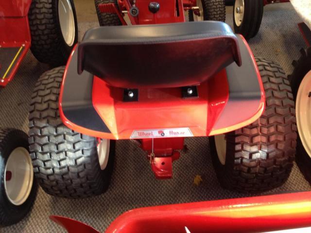

Don1977 606 #6 Posted December 25, 2012 i used 23 x 9.50-12's on the rear of my 1057 build. heres a pic.... heres my 1057 (with the 9.50's) on the left next to my c125 on the right (with oem 1980 turf savers in 8.50's) the width is most noticeable at the sidewall area, the wider ones bulge considerably more. the tread blocks are wider too..... these are both on oem 7" rims...... i think the narrower tires are a little taller though..... The wider ones are shorter, unless they are making them all shorter. Could be like everything else pay more and get less. I have as set on Carlisle Turf Masters when air down for the tread to sit flat they are only around 21 1/2" tall. these were bought in the late 80's or early 90's so they have been that way . I have them on 7 1/2" rims don't know if that a difference in height. I had 20# of air in them in this picture. Don't know how much is in them now, I let some out to get them to flatting out at the ground. Share this post Link to post Share on other sites
GlenPettit 1,719 #7 Posted December 25, 2012 I also agree, the tires being sold today certainly do appear to be slightly different, and on my tractors too, dealers always say that they are better now, but I wonder. (Like, do tennis shoes sold today, last & wear like "I think they used to" ?) The weight of the tractor on the tires and the air pressure do affect the tire appearance, but all things being equal, they are different today, and your pictures show it. -- 10# of air will have more rubber on the ground (softer-larger footprint), and 20# gives less rubber on ground and a slightly taller tire (firmer-smaller footprint), and more psi gives a little more traction in mud/snow. Soft for SUMMER mowing, hard for WINTER plowing. Share this post Link to post Share on other sites
Zeek 2,314 #8 Posted December 25, 2012 Thanks, these side-by-side comparison pictures are very helpful :popcorn: Share this post Link to post Share on other sites
