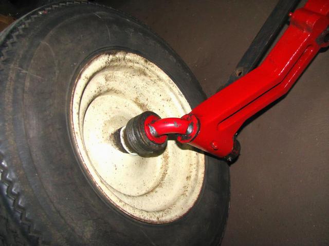

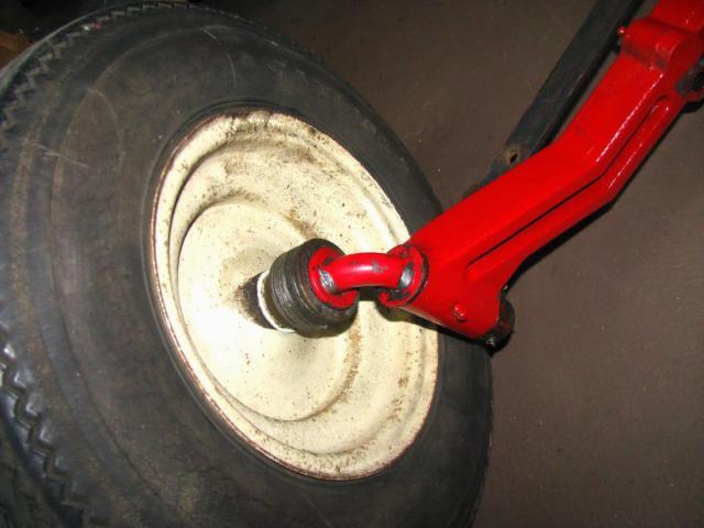

JimmyJam 542 #9 Posted December 25, 2012 I know...right, but that's the way I got it. Took me awhile to find the correct rims, and offset...but c'mon...they're out there. I totally agree Craig! On my Workhorse 800 the PO drilled-tapped- & washer-bolted front wheels to spindles. What the heck!!!! Share this post Link to post Share on other sites
Kelly 1,038 #10 Posted December 25, 2012 jimmy, you mean it has bolts in the ends of the spindles with washers to hold the rims on? if so that would be correct, most of the mid 60's to mid 70's are that way, and are the best, they don't pop off like C clips or snap rings, had that happen a few times when plowing snow not fun. Share this post Link to post Share on other sites
JimmyJam 542 #11 Posted December 25, 2012 Thanks Kelly. I thought all of 'em were pinned. This same Workhorse 800 has front tires of 18x8.50-8 ps: Kelly could you PM me: looking for fuel pump for that Tecumseh. Share this post Link to post Share on other sites
Kelly 1,038 #12 Posted December 25, 2012 No fuel pumps, but I'm pretty sure those front rims are not for that tractor, and about 90% sure there is no bearing or even bushings in them, they look like rear wheels off a MTD or such, and if they are they will be tearing up your spindles real fast. Share this post Link to post Share on other sites
Jake Kuhn 1,600 #13 Posted December 25, 2012 If I have not been able to have one wide enough to fit the spindle and did not have the correct one. I have put narrower rims on there and put a shaft collar on the spindle from keeping it from wobbling everywhere. ~Jake Share this post Link to post Share on other sites
JimmyJam 542 #14 Posted December 25, 2012 No fuel pumps, but I'm pretty sure those front rims are not for that tractor, and about 90% sure there is no bearing or even bushings in them, they look like rear wheels off a MTD or such, and if they are they will be tearing up your spindles real fast. Thanks Kelly! TT (Terry) mentioned the same in another thread when I posted pics. The PO gave me additional rims (rusty). What size tires should I use? Also can I use any garden tractor diaphram fuel pump? Share this post Link to post Share on other sites
