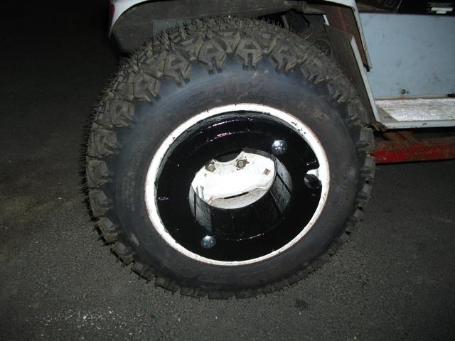

3609horse 27 #4 Posted December 24, 2012 Theres no issues with loading the rims in my opinion Steve, it doesn't load the axle or the axle bearings and seals. I've never seen a 50 pounder that would fit inside the rim tho. I have 50#'s on the outside and 25#'s on the inside of my rims. Mike........ Nice tires on your tractor, how are they in the snow? Share this post Link to post Share on other sites
Sparky-(Admin) 26,621 #5 Posted December 24, 2012 Nice tires on your tractor, how are they in the snow? Not sure yet, bought them this spring and they haven't seen snow yet. Hopefully this week we might get some according to the weather man. Mike......... Share this post Link to post Share on other sites

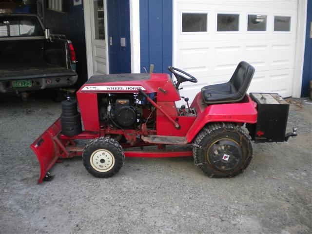

Tim 97 #7 Posted December 24, 2012 i have 50 lbs on each wheel and another 150 hanging off the back plus my 240ish works well i think i'm adding front weight too just not sure if it will be tombstone, cast weights for front rim or the front weight accessory 1 Share this post Link to post Share on other sites

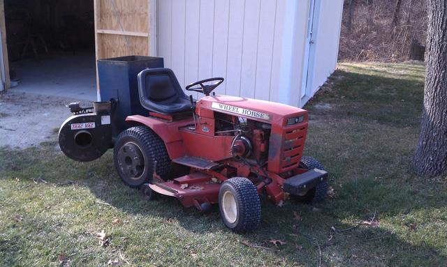

C-85 826 #9 Posted December 29, 2012 I'm not sure how much is too much, but this is what I've done on my C-85. This is no doubt overloaded, but I'll tell you it is nearly like a bull dozer now. My journey started out with adding a Reese hitch to the back and then a weight box. That worked good but then the front end was a little light, so I added the front wheel weights, but it was still light, then I made the front weight carrier. It never steered very well in snow, so I put on the soft snow hog tires on it, and now it steers a lot better. I have v-bar chains on the back. Now it is very good and I think this gets as much traction as it can and I'm really happy with it. I wish there was a locking rear end that really worked, I think that is the only thing that could make this any better. ! :) C-85 http://i1234.photobucket.com/albums/ff403/c85c85/Feb2012_3Small_zpsf5ffa64e.jpg Hope this link works, I tried to download a file and I guess my picture was too big. Share this post Link to post Share on other sites

Butch 194 #12 Posted December 31, 2012 Nice tires on your tractor, how are they in the snow? Not sure yet, bought them this spring and they haven't seen snow yet. Hopefully this week we might get some according to the weather man. Mike......... Gonna use them without chains? Share this post Link to post Share on other sites
Sparky-(Admin) 26,621 #13 Posted December 31, 2012 Nice tires on your tractor, how are they in the snow? Not sure yet, bought them this spring and they haven't seen snow yet. Hopefully this week we might get some according to the weather man. Mike......... Gonna use them without chains? Yep, I dont like the marks chains leave on the driveway. I used them today and they were great. Mike......... Share this post Link to post Share on other sites

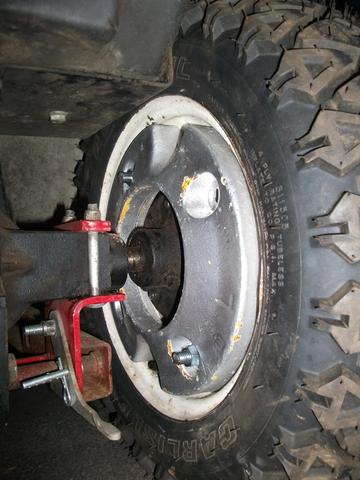

Hydro 131 #15 Posted January 6, 2013 I run 65 lbs on the inside of each wheel: Have considered adding the WH outside weights... But haven't run into a situation where I've felt I've needed it... I am curious, what are those inside weights from? Share this post Link to post Share on other sites

Sparky-(Admin) 26,621 #17 Posted January 6, 2013 They are Carlisle ALL-TRAIL 23x10.5x12. I mounted them on a pair of wide rims off a GT-1848 I stripped so the tread stayed flat and didn't balloon out. I've used them in the snow now and am happy to report that they are great! I keep the air pressure low so they stay a bit more "squishy" which I think helps with traction. Mike.......... Share this post Link to post Share on other sites
WheelHorseSteve 56 #18 Posted January 7, 2013 I run 65 lbs on the inside of each wheel: Have considered adding the WH outside weights... But haven't run into a situation where I've felt I've needed it... I am curious, what are those inside weights from? Not sure what brand... but they come and go on eBay from time to time. I managed to get two sets... one permanently mounted on the Ags on the C-120 and one on the chained 8.5 turfs on the C-160. The weights just BARELY fit around the hub... in fact, I had to do a little cleanup with the grinder to smooth out the casting imperfections so they would fit. Besides leaving the outsides looking unweighted they put the weight largely on the axis of the bearing which is surely better for it and the axle in general. I like the look a lot! Share this post Link to post Share on other sites

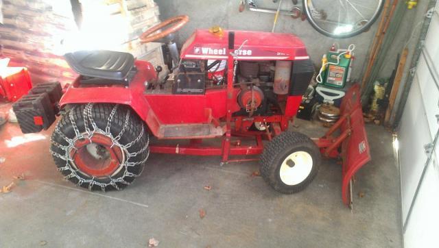

Hydro 131 #19 Posted January 7, 2013 I have my tires loaded, weighted and hang suitcase weights off the rear hitch. With the two stage snow blower out front the extra weight on the rear helps to counter balance especially in reverse or if the front wheels drop over the edge of pavement as the AGs don't have much traction in reverse. For the few hours my tractor is in use during the winter I don't think the suitcase weights will do any harm considering the way I see some of these tractors loaded up. 1 Share this post Link to post Share on other sites
WheelHorseSteve 56 #20 Posted January 7, 2013 I have my tires loaded, weighted and hang suitcase weights off the rear hitch. With the two stage snow blower out front the extra weight on the rear helps to counter balance especially in reverse or if the front wheels drop over the edge of pavement as the AGs don't have much traction in reverse. For the few hours my tractor is in use during the winter I don't think the suitcase weights will do any harm considering the way I see some of these tractors loaded up. Looks sweet to me! Share this post Link to post Share on other sites
