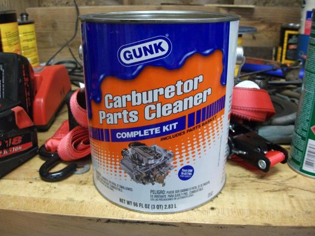

Sparky-(Admin) 26,360 #7 Posted December 22, 2012 If you do end up rebuilding it I recommend you get a one gallon container of carb cleaner such as this stuff. I used it with great results. Just take the carb apart and put it and all its parts in the metal basket that comes with the can and let it soak for 24 hours. It can soak longer. Mine sat in the can for almost a week before I had time to get it out and mess with it. Mike........... 1 Share this post Link to post Share on other sites
squonk 48,125 #8 Posted December 22, 2012 That's great stuff. about $31.00 at Advance Auto. Take the hair clean off of your carcass. If I get within 5 feet of the stuff, my wife will know it and make me get undressed outdoors! :jaw: 2 Share this post Link to post Share on other sites
