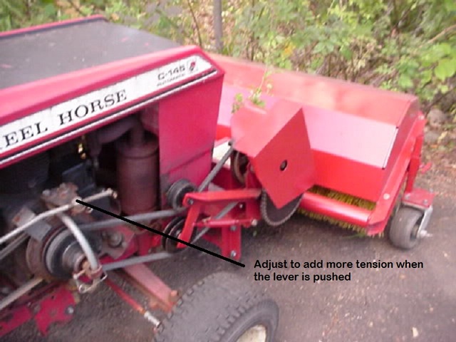

wallfish 20,669 #6 Posted December 22, 2012 (edited) :WRS: Also check the PTO pulley tension. That could be slipping and not the belt. Maybe a couple of turns on the trunion but don't make it too tight Edited December 22, 2012 by wallfish Share this post Link to post Share on other sites
bploof 2 #7 Posted January 4, 2013 Okay where's the trunion .. ? pics pls ... ? Oh ... & it seems that if I put the belt on the inside of the PTO it will throw off the belt alignment to the blower . ? Share this post Link to post Share on other sites
wallfish 20,669 #8 Posted January 4, 2013 Here's a pic of the adjustment I was referring to. DON'T over do it because it could add excessive side load on the engine shaft. A couple of turns should do it. 1 Share this post Link to post Share on other sites
bploof 2 #9 Posted January 5, 2013 Here's a pic of the adjustment I was referring to. DON'T over do it because it could add excessive side load on the engine shaft. A couple of turns should do it. Okay it was hard to push until I adjusted it back a few turns because it seemed to hard . Now it pushes over easier but stays engaged . I will give it a few turns & see what happens ... ? Share this post Link to post Share on other sites
