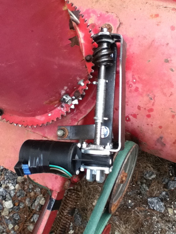

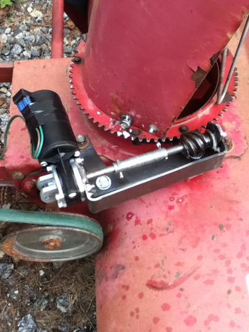

I also installed an electric motor to turn the shute on my tractor and will post a pick when I find my iPod. I wanted to take some video of the tractor in action today, but couldn't operate the iPod and the tractor at the same time by myself.

Post up some more pics of your tractor if you can, what's the chute motor off of?... Nice work! :thumbs:

name='dclarke' timestamp='1355829342' post='335947']

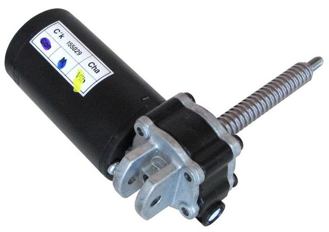

dclark,
The motor is a power seat motor from Allelectronics. Not sure what car it fits. I ground down the shaft with my angle grinder with the motor turning to keep it as round and true as possible, then used a 1/4" pipe nipple to connect the motor shat to a piece of 3/8" steel rod for the auger shaft. I kept the old parts from the blower, just took the spiral gear off the crank thingy and re-used that on my home-made gizmo. That way I can put everything back if things don't hold up.
I used a DPDT momentary toggle switch to make things go left and right. So far so good Granted, it is not up to the Duke's standards, but it works. :)
.http://www.allelectronics.com/make-a-store/item/DCM-563/12VDC-RIGHT-ANGLE-GEAR-HEAD-MOTOR-WITH-WORM-DRIVE/1.html

That really looks great Dave. Did you have to do anything additional for protection from moisture?
dbartlett1958
Gary,
The motor is pretty well sealed up, so nothing fancy. We will see how long it lasts and adjust acordingly.
David
KATO
Thats very cool. being a power seat motor it shouldn't have any trouble with ice either !!!
