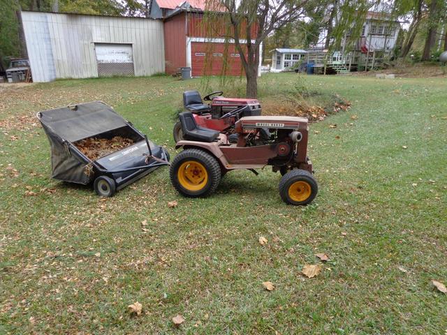

jay in nc 211 #13 Posted December 17, 2012 the commando 800 is one of my favorite horses! you scored big for $50 ! if you want to put bigger tires on it they will bolt up to the hubs, BUT for proper support you must change the rear hubs. heres mine with the big boy shoes. yours looks much nicer than mine was when i bought it out of asbury park nj. ebay $201 with snow plow, & 36 in rd deck. Share this post Link to post Share on other sites

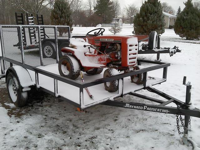

glgrumpy 35 #18 Posted December 22, 2012 Update! Got the rig off the trailer today and went to try and start. Jumped it, no key actoin. Direct connect starter and it cranks, no spark even with key on. Wiring kind melted at switch. Then, realized it had brake/clutch safety switch. Hit the pedal and cranke and sparked. Plug back in and either, popped off easy. Runs great and NO smoke. Took for a little ride and seems nice steering and running, cept 3rd gear pops out, unless I hold lever over. Let it run awhile to see if Batt would charge. Nope! Made a noise, then fizzled. Think it's pretty shot. Put in house garage for now, out of the weather! Share this post Link to post Share on other sites
