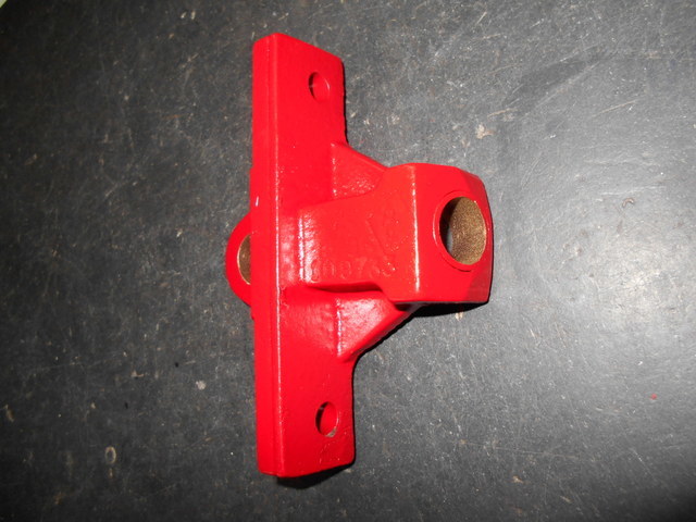

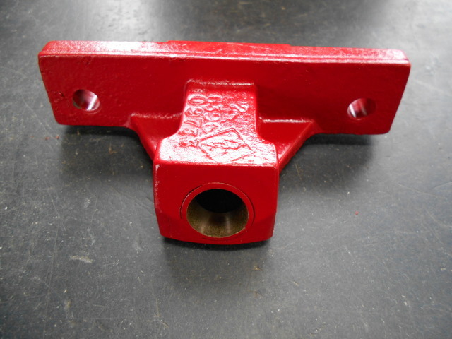

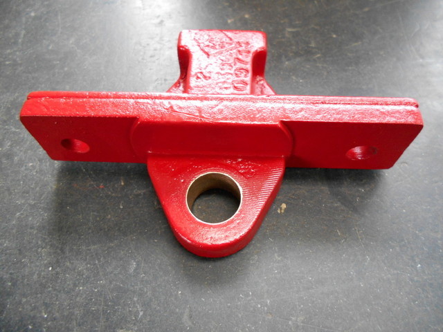

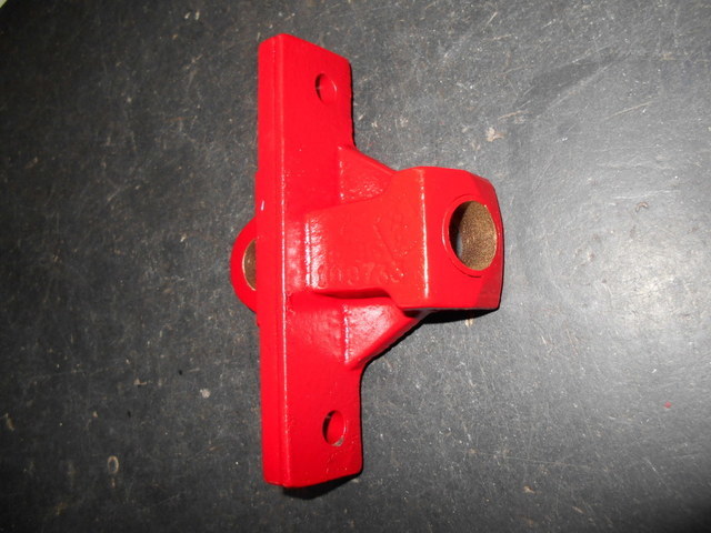

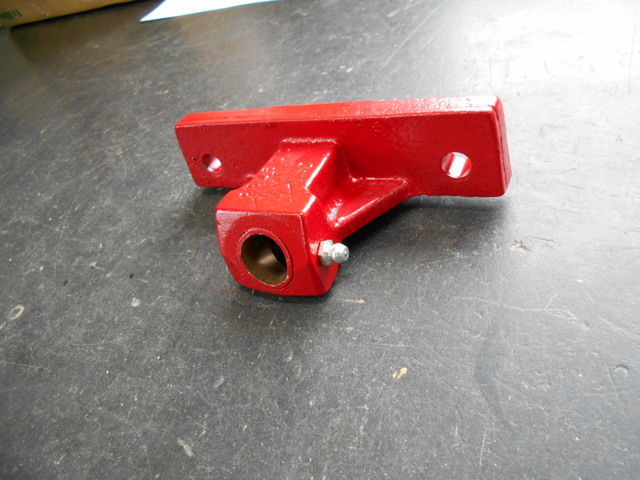

tormater 12 #13 Posted June 4, 2015 Hi all, I see this is a older post but I will give you my 2 cents anyways, I recently restored a 416H that had a lot of play in the steering and what I found was that block that holds the 2 steering shafts were oblonged meaning not round anymore, so I purchase 2= 3/4" bronze bushings on ebay and had my family's machine shop ream out the holes to .912 I think it was and press in the bushings, it is about as good as new now! I realize not everyone has a machine shop that would be benifisial to do the work on hourly labor but for me it paid off, and this was the issue on my tractor for sure! The hole was wore from side to side which makes more than sense since that is way way the shaft is under pressure when ya turn the steering wheel with the gears. One thing I didn't like on mine however was the only thing to keep the shaft tight in that block was a cotter pin????? My friends 416H has a nice castle nut on threads with the pin through the nut which looks a lot better to me!!!!!! When did Toro change this????? There is no way my shafts ever had threads on it! I wasn't worn that much it measured real close to the 3/4", I liked the way my friends is a lot better and it would keep it tighter. 1 Share this post Link to post Share on other sites

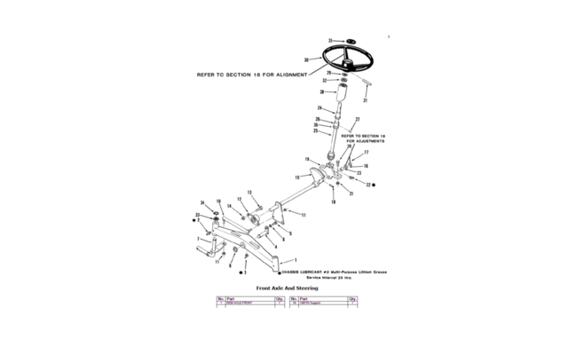

T-Mo-(Moderator) 4,939 #18 Posted June 19, 2016 Resurrecting an old thread. My 416-8 pops when getting to full lock. What's happening is this: As the gear on the column (item 25 below), it pushes the quadrant (item 15) forward which means the gears pop out of one another. What the PO was told by Mueller Motors in Desoto, Missouri, an old Wheel Horse dealer who still handles Toro, was to shim the flange (item 12) somehow to force the rod of item 15 back to keep contact with the column gear, (item 25). I'm not sure how to do that, but I can see the quadrant (item 15) popping off the column gears when it gets to a certain point in the turn. 1 Share this post Link to post Share on other sites
cleat 9,324 #19 Posted June 19, 2016 Wrong.. You add shim washers #16 & 17 until the play is gone without the gears binding. First though make sure the steering shaft is being held down and has no up and down play by adjusting the collar #26 and grip ring #36. 4 Share this post Link to post Share on other sites
squonk 48,076 #20 Posted June 19, 2016 And make sure #19 isn't busted or wallowed out. That's what I always find. 1 Share this post Link to post Share on other sites
cleat 9,324 #21 Posted June 20, 2016 I have rebuilt a couple of those blocks. I drill out the holes and install bushings then drill those for grease passages to work with the grease fittings. This style of steering can get tightened up quite nicely. Much easier than the gear reduction steering, but that is another story. 6 1 Share this post Link to post Share on other sites
T-Mo-(Moderator) 4,939 #22 Posted June 20, 2016 3 hours ago, cleat said: Wrong.. You add shim washers #16 & 17 until the play is gone without the gears binding. First though make sure the steering shaft is being held down and has no up and down play by adjusting the collar #26 and grip ring #36. More than likely the PO misunderstood and thought they were talking about shimming the rod at item 12 end instead of the other end. I couldn't figure out how shimming the forward end will help as it probably would have made it worse. Share this post Link to post Share on other sites
TDF5G 2,074 #23 Posted June 20, 2016 (edited) Shimmed up my B-80 not long ago. You put the shims on the back side of the support, #19. See this thread for pics. Edited June 20, 2016 by TDF5G 1 Share this post Link to post Share on other sites
T-Mo-(Moderator) 4,939 #24 Posted June 20, 2016 1 hour ago, TDF5G said: Shimmed up my B-80 not long ago. You put the shims on the back side of the support, #19. See this thread for pics. According to the IPL, it says to see section 18 for adjustment with these shims. Anyone have that SM or a link? Thanks. Share this post Link to post Share on other sites
