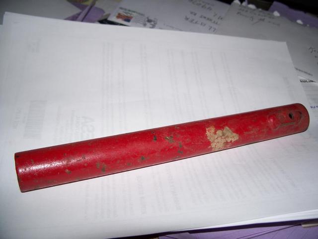

Shynon 7,596 #1 Posted December 9, 2012 Did a search and could not find, so my apologize as I though I have seen this discussed before. I have 2-62 lawn rangers and both are missing the stub shaft that holds the right foot stirrup. I am looking for dimensions for this, or if you have a spare you would like to get rid of. Thanks Shynon Share this post Link to post Share on other sites

Kelly 1,038 #5 Posted December 9, 2012 If anyone needs the right side foot rest I have a NOS one setting right here on the desk, send me a PM. With this ext. on it will be your foot rest, a standard footrest will not fit over this piece. This is the one I have, paint is a little beat up but what do you want for 50 years old. Share this post Link to post Share on other sites
Shynon 7,596 #6 Posted December 10, 2012 After seeing the NOS Kelly has I looked at my donor ranger and it has one on it although it is on backwards. I thought it was just a piece of pipe. Looks like I will make and extension to install a stirrup. Share this post Link to post Share on other sites
