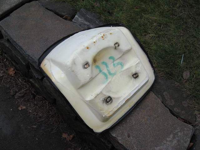

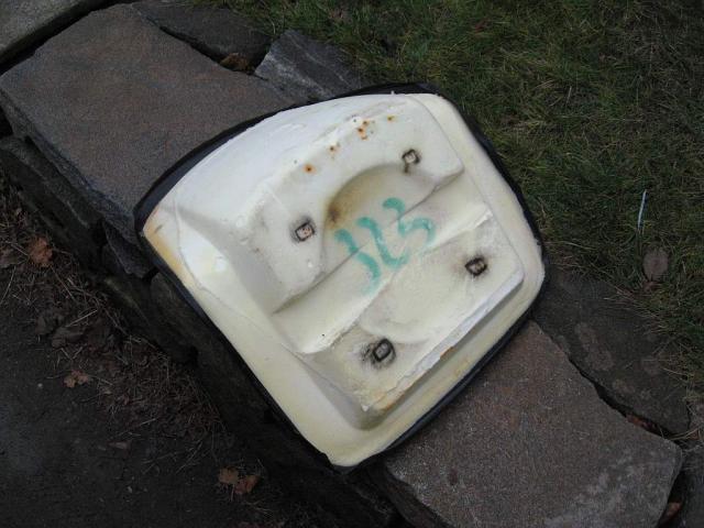

copperhead 38 #1 Posted December 9, 2012 It only has the cover with the foam...no frame...Is there any way to identify it as being for a Wheel Horse? I only know it doesn't fit mine... Share this post Link to post Share on other sites
Sparky-(Admin) 19,665 #2 Posted December 9, 2012 Genuine Wheel Horse seats had the Wheel Horse head emblem/logo in the backrest section. I think thats just a generic seat cover replacement. Mike......... Share this post Link to post Share on other sites

JackC 616 #5 Posted December 18, 2012 That is not genuine wheel horse. It is a replacement that matched a style used in the late seventies to mid eighties. The genuine wheel horse version of that style had a logo imprinted on the back rest. That style seat came in low, medium and high versions. It looks like it should fit the medium height seat pan for a late seventies to mid eighties wheel horse seat. Show us a picture of the seat you say it does not fit. Share this post Link to post Share on other sites
Don1977 604 #6 Posted December 18, 2012 That is a cover for a high back Michigan Seat don't know when it was made. It is close a replacement seat for the 70's Wheel Horse. I don't have the original seat pan off my 1977 C-120 but as I remember the metal pan is different. You would have to trim some foam on that one to get it to fit on the original pan. The seat pan for that seat has a two off set each side that the original did not have. I have one made in the 80's it is more like the original and does not have those offsets at the back. Here is another thread on Michigan Seats. Share this post Link to post Share on other sites

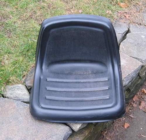

Don1977 604 #13 Posted December 19, 2012 That seat looks just like a "C-Series" with out the logo from the front but has extra foam on the back. Here is another replacement Jackson seat pan. That is similar to the original Wheel Horse seat. The original didn't have those four creases. Share this post Link to post Share on other sites

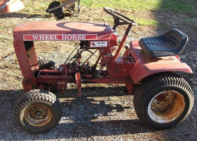

TT-(Moderator) 1,129 #14 Posted December 19, 2012 This was my '75 B-80 4 speed: I found a perfect (and identical) seat on a Simplicity 3110 rear-engined rider, but the mounting holes were different. My 'fix' for wrong bolt patterns: I pull the edge trim off and remove the cover & foam. Lay out and drill the four 3/8" holes (gives you a little 'wiggle room') in the correct locations, secure the seat to the mounting surface with 5/16" bolts & plain nuts (up through ~ like normal), and weld the nuts to the 'top' of the seat pan. Reinstall the cover and edge trim and it's done. If you don't have a welder or access to one - or the seat has a plastic pan with a removable cushion - you can install the pan and tighten the fasteners, then install the cover & edge trim. 1 Share this post Link to post Share on other sites
