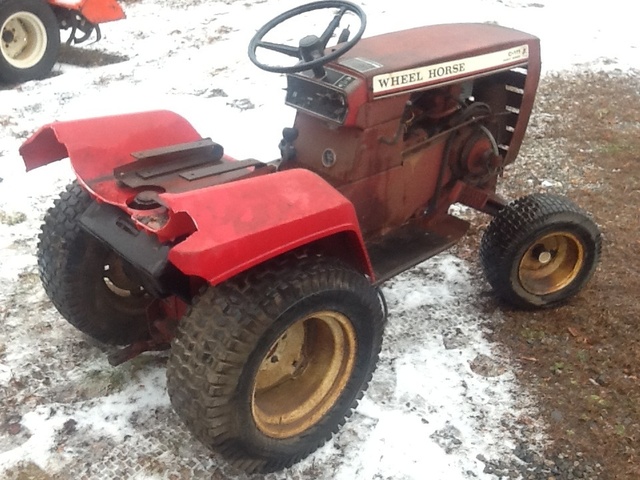

Rock farmer 45 #1 Posted December 2, 2012 This just came my way Share this post Link to post Share on other sites
TT-(Moderator) 1,185 #2 Posted December 2, 2012 It's not hard to figure out where the original fender went. Those 'Tupperware' fenders were definitely a bad idea..... and we all know who was in charge of Wheel Horse when they appeared. :silence: 2 Share this post Link to post Share on other sites
Kelly 1,038 #3 Posted December 2, 2012 Ya the fenders are now on a black hood someplace, but I never seen a set of plastic ones on a older tractor, they are even uglier than on the C-xx5 tractors. 2 Share this post Link to post Share on other sites
Rock farmer 45 #4 Posted December 2, 2012 My brother got this for me. It was on its way to the scrap metal dealer. He paid $30 for it. Funny thing is that seat pan was good, when loading it into the truck the the po slipped and the tractor hit on the head! What do you guys think of that Briggs? Joe Share this post Link to post Share on other sites
Sparky-(Admin) 26,686 #5 Posted December 2, 2012 Ya the fenders are now on a black hood someplace, but I never seen a set of plastic ones on a older tractor, they are even uglier than on the C-xx5 tractors. Yep. black-hoods are my favorite's minus the nasty fenders. I have swapped all mine to metal ones off a 300 series. Some people love those Briggs motors and some hate em. Its probably a good motor, better than a Tecumseh any day! Mike.......... 1 Share this post Link to post Share on other sites

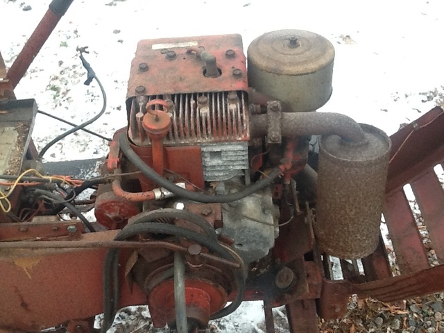

TT-(Moderator) 1,185 #6 Posted December 2, 2012 I have nothing bad to say about the Briggs engine. You will need to make sure that the bearing behind the engine pulley is intact and functioning correctly. Service bulletin 326b: http://www.wheelhors...ing-preloadpdf/ Without that bearing, the crankshaft gets forced into the flywheel side of the block when the PTO is engaged. I have actually seen one smear the block so bad that oil couldn't get to the main journal and the crankshaft seized in the block. 1 Share this post Link to post Share on other sites
sgtsampay 166 #7 Posted December 2, 2012 Very nice fine and I think those old briggs engine are just as good as the Kohler. They are lighter in weight and not as much torque but they are good for wat they are. Way better than a tec in my book. 1 Share this post Link to post Share on other sites
rick 321 #8 Posted December 2, 2012 i have one, and I like it. the short block had been replaced on mine, and has a ball bearing on the flywheel side of the crankshaft. I did not use the external bearing when I rebuilt the engine. No problems yet. The exhaust port threads on mine were boogered up from the factory exhaust shaking, so I used B&S 691874 muffler and 795036 deflector. This muffler bolts directly to the block, and the deflector shoots the exhaust out the right side. Works for me, and no louder than the OEM setup. 1 Share this post Link to post Share on other sites

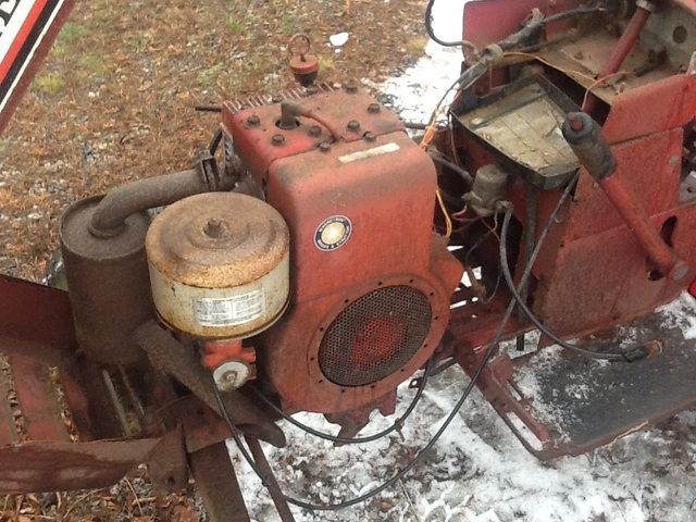

Rock farmer 45 #9 Posted December 2, 2012 So, I went to put a battery in and unfortunately, it was dead. It was on the charger most of the day. When it was charged I got nothing. I'll look into it later. I did check the brake pad on the tranny and the pad on the pto clutch Neither is worn! However, the rubber engine mounts are shot! The engine rocks about an inch or more when I move the pto lever. Hopefully it never ran like that. The drive pulley looks good so I'd say the bearings are there and good. It has too much oil in it. It didn't smell like gas. But I'd say this hasn't run in five or ten years! And I took that seat pan off! It'll be in the dumpster tomorrow! Joe Share this post Link to post Share on other sites

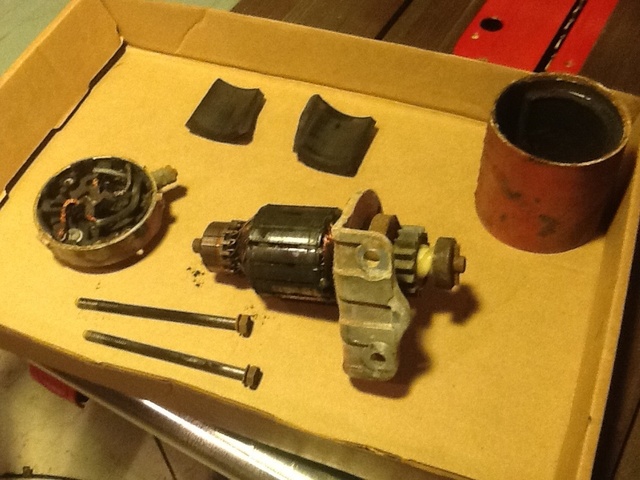

Rock farmer 45 #17 Posted December 8, 2012 Charged up a battery and put it in the tractor. Nothing! Jumped the starter. Nothing! So, I took the starter out. Will bench test it tomorrow. Share this post Link to post Share on other sites
Rock farmer 45 #18 Posted December 9, 2012 Bench tested the starter. And it worked! I think I'll still dis-assemble and clean it though. Share this post Link to post Share on other sites
Rock farmer 45 #19 Posted December 19, 2012 Update; Finally got around to taking the starter apart. I never seen a starter magnetic brake and come loose! Anybody ever glue one together before? I've got some west system two part apoxy. What have I got to lose! Joe Share this post Link to post Share on other sites
rydogg 186 #20 Posted December 19, 2012 It's worth trying...they usually get knocked loose like that by someone hitting the starter. I have a starter from my C111 that has the mounting bracket broken off but the rest is good you can have it if it will help you out PM your address and I can send it out this week. 1 Share this post Link to post Share on other sites
