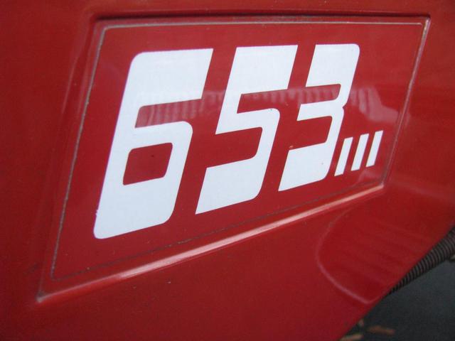

AMC RULES 37,259 #4 Posted December 1, 2012 My 653, the five designates it's electric start. 2 Share this post Link to post Share on other sites
