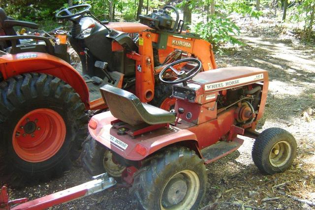

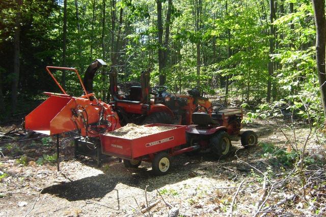

vic4news 0 #17 Posted April 29, 2014 I used my C-81 all last year. Mostly to haul woodchips. THe low speed transmission is nice to use in the woods. Last fall the carb started to overflow with gas. I suspect that the float is stuck. I'll probably need to take it apart and clean it this year. Here are a couple of pictures using it while woodchipping. Vic Share this post Link to post Share on other sites
