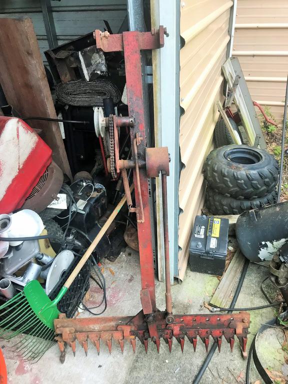

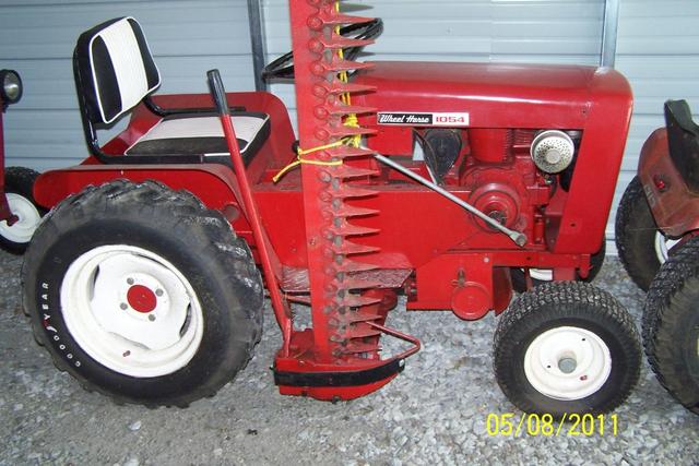

Lane Ranger 12,150 #26 Posted June 3, 2019 CBR -327 Pictures. This was a one year only model made for the 1961 Wheel Horse 701 garden tractor. 1 Share this post Link to post Share on other sites

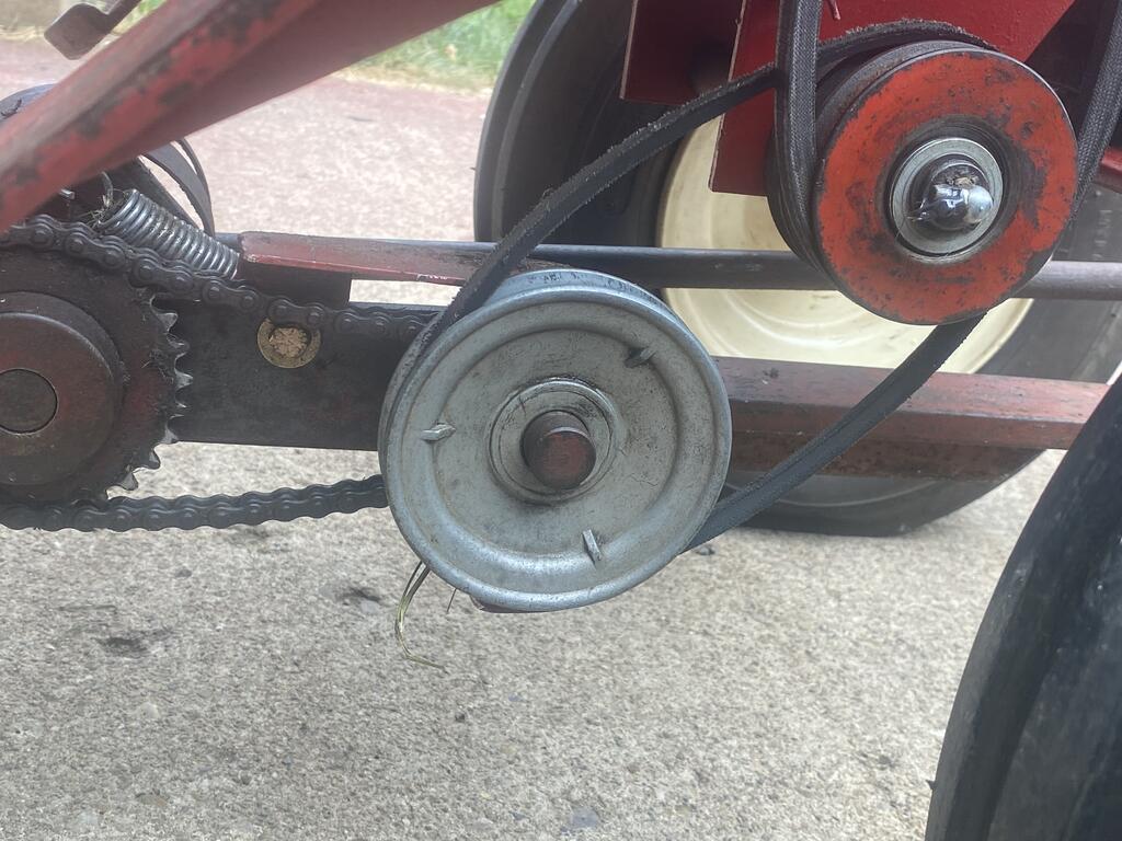

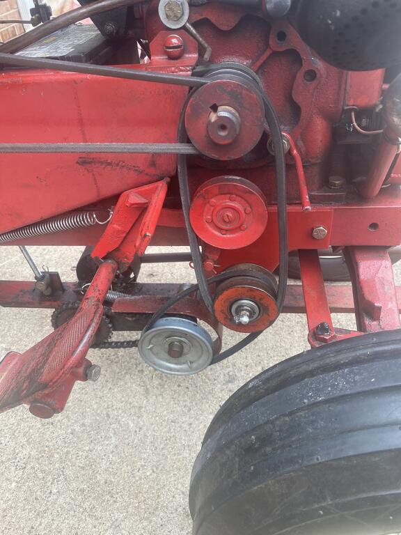

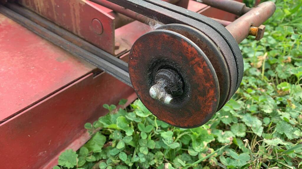

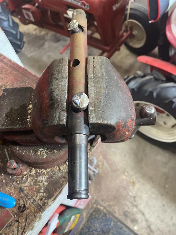

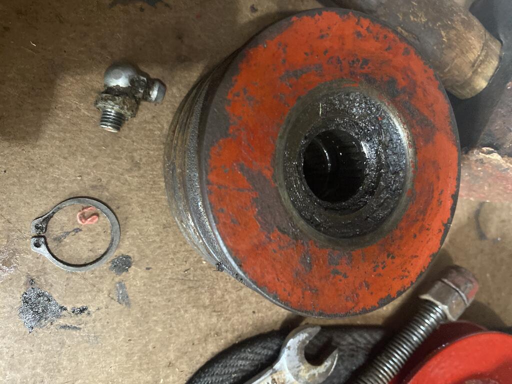

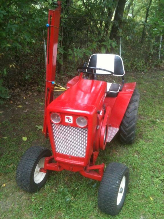

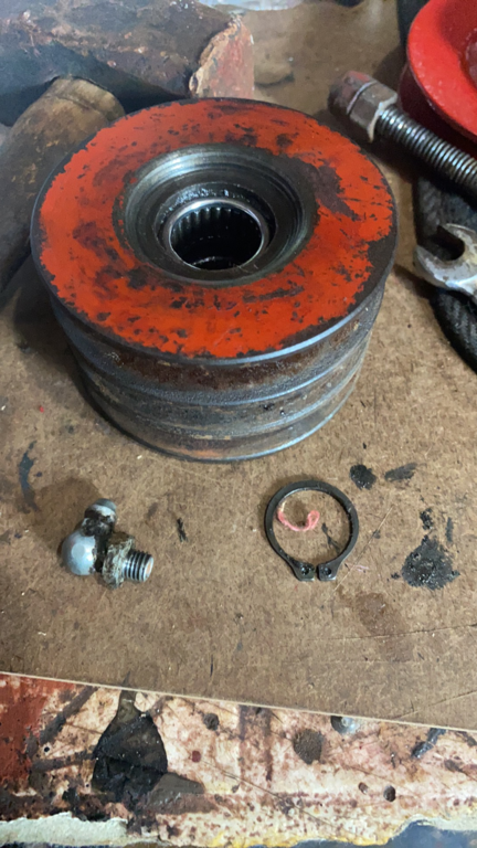

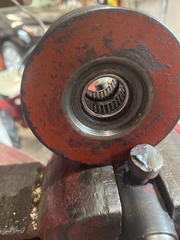

Lane Ranger 12,150 #31 Posted September 7, 2020 (edited) CBR-327 owners need this information. This CBR-327 front cutter bar made in 1967 should have a pto set up that uses a 3 race pulley with needle bearings and grease fitting ( like the one on front of 196/ and later gear driven mower decks). I had to take one from an old deck . There are two V belts needed to operate this. One from the motor drive pulley to the frame side plate PTO setup. 27 x 1/2. Belt and you use the regular mower idler and engagement pedal on the right foot peg. The other V belt goes from PTO to the chain drive pulley. That is a 21 x 3/8 V belt. I have a Hein Werner hydraulic pump to lift the cutter bar on my 701 so I have another couple issues. The original lift bar is 12 inches long. I found the cutter bar would run even when not engaged with the idler pedal. The belts had just enough tension to do so. So I used some all thread and placed it about ten inches long as a new lift bar. The cutter bar shuts off when lifted now. Edited September 8, 2020 by Lane Ranger Share this post Link to post Share on other sites
