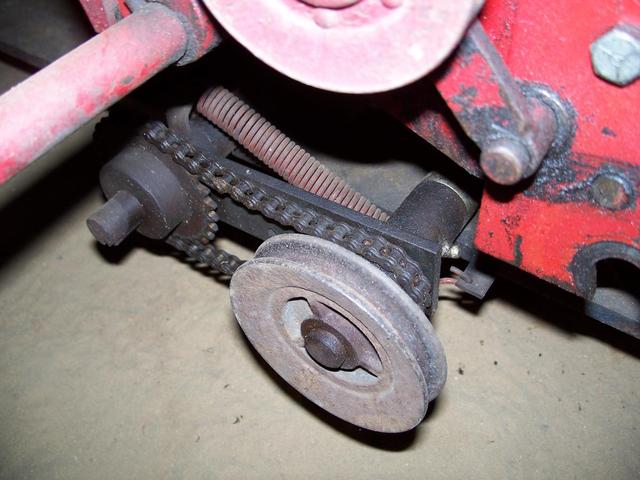

Kelly 1,038 #7 Posted November 27, 2012 (edited) The one Jason posted pics of is mine, it's kinda packed in the barn still on the tractor, but if needed I can try to get better pics, I never hooked the belt up, but it is belt to a jackshaft that in turn is speed reduced with the gears and chain, there is not room to have the large pulley like on the RJ models, some place I have a copy of a price chart from 1961 and it's on it for like $79 I think the model no was CBR-732 for the new then 701 tractor. I found the picture of the price sheet I have it is hard to read because it is a scan of a old sheet, then emailed to me, but it is a CBR-327 for the 700 series tractors, no price or more info on it, the CBR-32 listed above it was $79 Edited November 27, 2012 by Kelly 1 Share this post Link to post Share on other sites

CasualObserver 3,416 #9 Posted November 28, 2012 I never hooked the belt up, but it is belt to a jackshaft that in turn is speed reduced with the gears and chain, there is not room to have the large pulley like on the RJ models You know, that makes sense. Wheel Horse used that same chain setup to run the PTO-66 Farm PTO too. I found the picture of the price sheet I have it is hard to read because it is a scan of a old sheet, then emailed to me, but it is a CBR-327 for the 700 series tractors, no price or more info on it, the CBR-32 listed above it was $79 You know, now that you mention that Kelly, I think I've heard that CBR-327 number mentioned before somewhere. Could have been like you and only seen it on a price list... I just don't remember. Aren't there 1961 and 62 price lists in the back of Martino's book? Maybe someone will chime in during the day. Otherwise I'll look when I get home. In the meantime, I will change the topic title, so it can be found in searches in the future. Share this post Link to post Share on other sites
CasualObserver 3,416 #10 Posted November 28, 2012 I wonder now about the model number.... I see in Keith's old post here when he found one he called it a FCB-327. If anyone gets a price list out and looks, please post the right number. CBR-327 or FCB-327. And I found another picture of Kelly's before it was mounted on the tractor and put it in the first post. Shows the chain gear reduction pretty clearly. Share this post Link to post Share on other sites

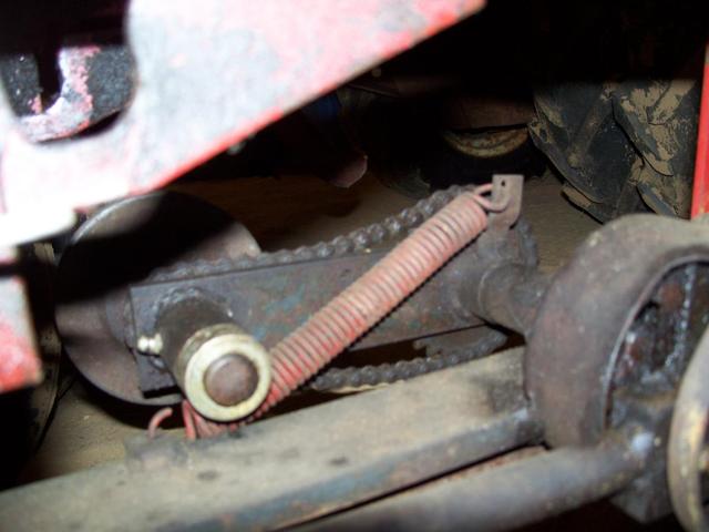

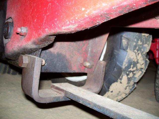

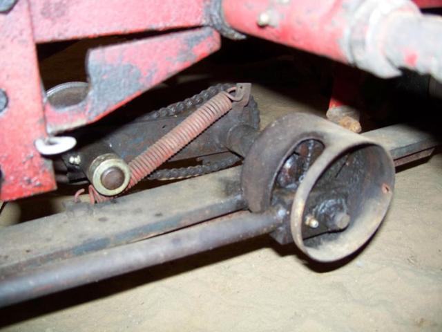

Kelly 1,038 #12 Posted November 29, 2012 I didn't find the one in the brochure section?? I did go out to the barn and snapped a few pics of the chain set up, and how it mounts to the tractor, like I said I don't have the belt on mine. Drive from the right side of tractor drive from the left side looking under tractor This is how it mounts to the back of the frame at the trans mount, mine even came with the odd sized shoulder bolts, with out pulling them I think the step was about 5/8" turned down to the 3/8" thread, the sickle bar mount has large holes in it. Share this post Link to post Share on other sites
