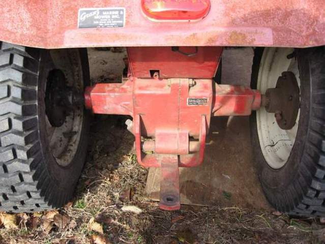

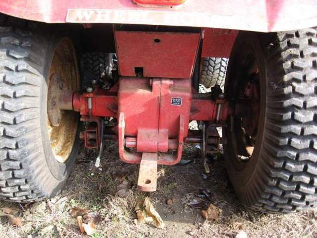

copperhead 38 #1 Posted November 26, 2012 or does it even matter?...When I was swapping a quick attach from one machine to another I noticed the hubs on my C-100 are spaced away from the axle casing...The ones on my B-80 they are almost touching the casing...Am I comparing apples to oranges or is something amiss here?....The first picture is of the C-100 the second is the B-80.. Share this post Link to post Share on other sites
Sparky-(Admin) 26,417 #2 Posted November 26, 2012 The C-100 is correct. I was always told the hubs should be flush with the ends of the axles. Look inside the rear rims of the C-100. I bet they are flush. Mike.......... Share this post Link to post Share on other sites
stevebo-(Moderator) 8,742 #3 Posted November 26, 2012 what mike said.... Share this post Link to post Share on other sites
1maidenfan 203 #4 Posted November 26, 2012 YEP :handgestures-thumbupright: Share this post Link to post Share on other sites
sorekiwi 761 #5 Posted November 26, 2012 Yep again. Share this post Link to post Share on other sites
copperhead 38 #6 Posted November 26, 2012 I went out and looked and the C-100 hubs are indeed flush with the end of the axle.....But so are the B-80's...Different axle lengths I presume?....Thanks for the info... Share this post Link to post Share on other sites
rustyoldjunk 127 #7 Posted November 26, 2012 I know i have noticed some different axle shaft lengths on different models over the years,not really sure why.i did notice on your B80 that the hub collars appear to extend out a little farther then the hubs on your C. Share this post Link to post Share on other sites
copperhead 38 #8 Posted November 26, 2012 I know i have noticed some different axle shaft lengths on different models over the years,not really sure why.i did notice on your B80 that the hub collars appear to extend out a little farther then the hubs on your C. Looking at the pictures again it does seem like the B80 collars are a bit longer...I'll have to measure them both tomorrow and see if that's part of the reason for the difference... Share this post Link to post Share on other sites
Kelly 1,038 #9 Posted November 26, 2012 Some axles are longer than others, and hubs are not all the same, but like was said set the face of the hub flush with the end of the axle, so the set/lock bolt is centered over the key in the axle, that is the main thing you want, but 99% of the time if the hub is flush your good. Share this post Link to post Share on other sites
