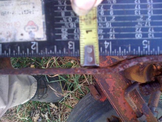

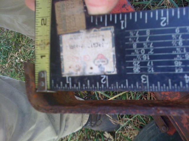

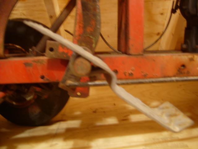

clemedc 29 #1 Posted November 25, 2012 can anyone get me the dimensions of the footrest on a Suburban 400 like the length and where the bends are? All I have to go by is these. http:// Share this post Link to post Share on other sites
clemedc 29 #2 Posted November 25, 2012 I also need to find out how this bracket should be shaped Pics of correct footrest and this bracket would be helpful. Thanks http://i254.photobucket.com/albums/hh89/clemedc/Garden%20Tractors/Suburban/400-401/SANY1747.jpg"]http:// Share this post Link to post Share on other sites

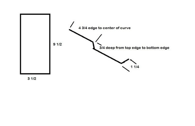

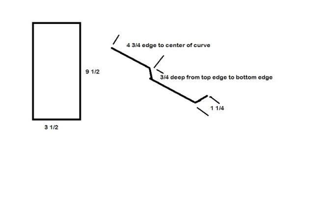

wallfish 20,733 #5 Posted November 25, 2012 Let me know if you need anything but this should get you going. The bottom bend is not at 90 deg but more like 75 deg 1 Share this post Link to post Share on other sites
clemedc 29 #6 Posted November 26, 2012 Wow Thanks so much. I never got any notification of your reply and I usually do. THANKS AGAIN WALLFISH Clem Share this post Link to post Share on other sites

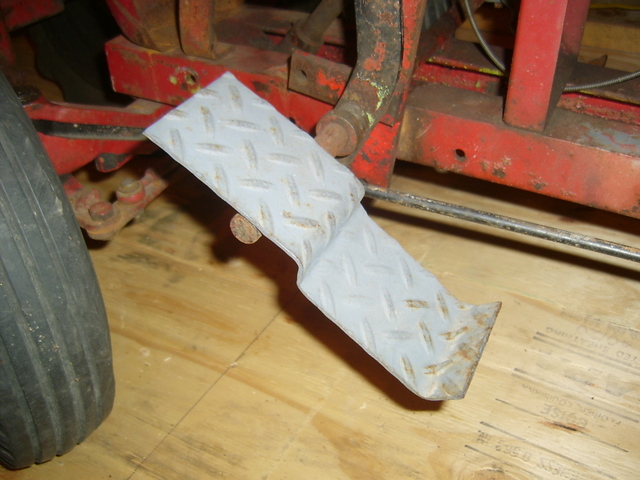

CasualObserver 3,417 #7 Posted November 26, 2012 Don't have measurements handy, but I had these pictures on here somewhere. You should be able to approximate the dimensions pretty well from what you have. Share this post Link to post Share on other sites
clemedc 29 #8 Posted November 26, 2012 Thanks alot Casualobserver Clem Share this post Link to post Share on other sites

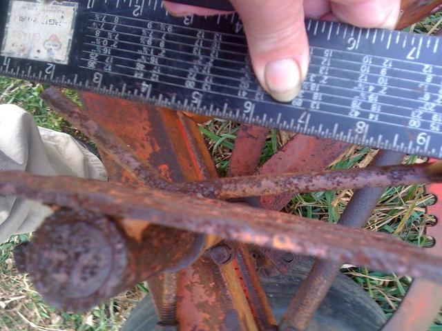

Callen 64 #9 Posted November 26, 2012 Maybe these can help too,(not very good) The off set on the engagement pedal on mine is 1-1/4 from the weld to the straight edge Share this post Link to post Share on other sites
clemedc 29 #10 Posted November 26, 2012 thanks Chester it all helps :) Share this post Link to post Share on other sites
Callen 64 #11 Posted November 26, 2012 Looks like all my bends are different from the first pictures, I set the square flat on the top flat. Didn't have enough hands to get far enough away to get the whole thing in the pics. Share this post Link to post Share on other sites
