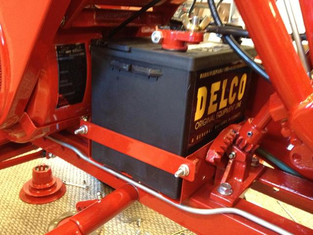

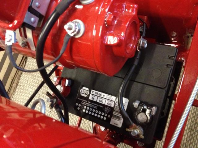

Martin 2,134 #18 Posted December 15, 2012 some of the 60s tractors you could get a small car battery in. my 1057 uses a group 26 car battery, fits in the standard size battery tray...... 1 Share this post Link to post Share on other sites
Kelly 1,038 #19 Posted December 15, 2012 Martin are you sure that is a standard batt tray?? I thought those tractors had the big tray?? Share this post Link to post Share on other sites
Martin 2,134 #20 Posted December 16, 2012 Kelly, I guess I should clear that up a little. It's a standard 1057 tray. Which as you would know is larger than the 'normal' lawn and garden battery tray. Sorry for any confusion. Sent from my iPhone using Tapatalk 1 Share this post Link to post Share on other sites
Kelly 1,038 #21 Posted December 17, 2012 I just don't want anyone to think it will fit all tractors, and those big trays are hard to find in good shape. Share this post Link to post Share on other sites
Martin 2,134 #22 Posted December 17, 2012 (edited) can the big trays be fitted in place of the small ones? i think from memory (been some time since i was fabricating the tray for my 1057) that the large ones had 4 bolts for fixing and the small ones had two. so if you had the room (maybe not on the small frame tractors) to replace a small tray with a large one, you could indeed use a group 26 battery..... just thinking out loud i guess..... and anyone with basic fabricating skills and primitive metal folding capabilities could fabricate a large tray from scratch, or as i did with the 1057, from a rusty original. i still have that rusty tray in my good scrap steel pile if anyone would need dimensions etc..... another thought, the large batteries are nice i guess if you have a larger electrical load or maybe they would hold on a little longer towards the end of their useful life, but i only have one tractor with the larger battery and i use most all of them at one time or another. i can honestly say that even the ones with smaller l&g batteries in them ive never had any trouble with, starting wise, just have to maintain them a little and have good starting and running engines. if the thing starts easy then your not going to strain the battery every time you kick it in the guts and it will last longer. of the l&g batteries i have 2 of them are at least 3 years old (an interstate and a napa) and the one on my c125 has a 2008 date on it (some sort of jd battery). Edited December 17, 2012 by Martin Share this post Link to post Share on other sites
Kelly 1,038 #23 Posted December 17, 2012 I'm not sure with out checking but I think the big trays stopped when they went to the gear drive starter, there may not be room for the bigger batt. with the gear drive starter, again not sure never tried. Share this post Link to post Share on other sites
Martin 2,134 #24 Posted December 17, 2012 (edited) just looking at a pic of my c160 (didnt want to trek out to the garage) and i think if the oil drain for the engine was moved then you would have room for a bigger tray. without measuring im not sure what size tray is in the c160 and whether its the same as the large or small earlier ones. still with a little work, it could hold something bigger i think. i remember when looking for that group 26 that there was a couple other car type batteries around the same size.... Edited December 17, 2012 by Martin Share this post Link to post Share on other sites
sorekiwi 761 #25 Posted December 17, 2012 The tractors with the big trays have the oil drain on the front of the motor. And as far as I know they are all s/g motors. The big tray will definately not fit with the oil drain on the back of the motor, Share this post Link to post Share on other sites
