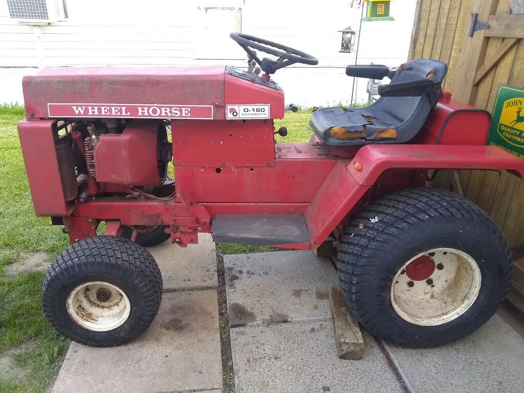

bottjernat1 2,197 #20 Posted June 10, 2020 I always tube tires. I just bought new shoes for my d-160 and i had all 4 tubed. I always tube tires. My late dad did so i do. 1 Share this post Link to post Share on other sites
