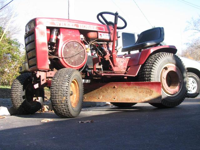

whc160 80 #56 Posted November 24, 2012 Discovered this crack in the lower hood stand on thanksgiving day... any ideas what would posssibly cause this to happen? Heaving too hard on the lift lever and/or using the steering wheel as a grab handle when mounting/dismounting. Craig 3 out of 4 of my C-160's had cracked hood stands at the bottom. One was on the left side like yours. The other two were on the right under the belt guard. On the two that I fixed I found that the mountings bolts in the frame had come loose, I think to do with what TT said. The one when I got it was already fixed before I bought it. 1 Share this post Link to post Share on other sites

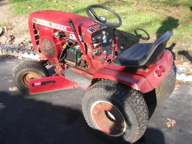

AMC RULES 37,251 #57 Posted November 25, 2012 Just wish I would've discovered it before mounting this new score I cherry picked from my buddy's Jacobsen collection. All mounted up, then I discovered the spring in the lift handle is also broken... AARGH! Share this post Link to post Share on other sites
roscoemi 245 #58 Posted November 25, 2012 I'm more than willing to take that blade off your hands seeing as you can't use it! :ychain: Share this post Link to post Share on other sites
