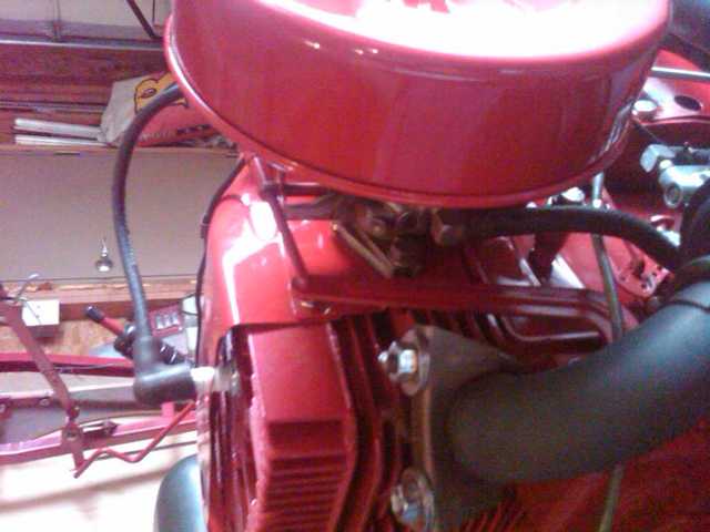

MaineDad 87 #8 Posted November 28, 2012 In the first picture, the throttle stop is set way too low. It should be at about 1 O'Clock and it looks like it's at 3 or 4. Do you see that? Share this post Link to post Share on other sites
TT-(Moderator) 1,185 #9 Posted November 28, 2012 In the first picture, the throttle stop is set way too low. It should be at about 1 O'Clock and it looks like it's at 3 or 4. Do you see that? I see it. It's definitely not in the 'normal' position. @608KEB: Did you use an OEM throttle control as the replacement part? Share this post Link to post Share on other sites

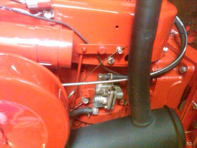

rmaynard 17,642 #10 Posted November 28, 2012 In the last picture, the spring appears to be set in the third hole up from the bottom. Which hole is the other end of the spring attached to on the upright governor arm? On my two B-100's, the spring is attached at the the third hole up from the bottom on both. My guess would be that the governor arm is loose on the cross shaft, or the cross shaft to governor arm adjustment is incorrect. Share this post Link to post Share on other sites
