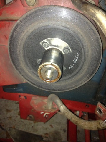

Wheelhorse84 87 #10 Posted November 27, 2012 So this is what it looks like underneath the PTO pulley on my C1 60. I took the pulley off my b100 and in that threaded hole was some screw with two washers on the end of it in and that one on that tractor works perfect. And my missing the screw at the end of this shaft with the two washers in order to make my pulley go in and out the right way. And also is there spring inside there that goes on the surface of that crankshaft and pushes on the pulley any diagrams or pictures would be appreciated. Share this post Link to post Share on other sites
rmaynard 17,612 #11 Posted November 27, 2012 The B-100 and the C-160 should both have the stud in the end of the crankshaft with two thrust washers and a spring to help push out the PTO bell. If you are missing them, that is your problem. Share this post Link to post Share on other sites
Wheelhorse84 87 #12 Posted November 27, 2012 Great now I know how to fix it Share this post Link to post Share on other sites

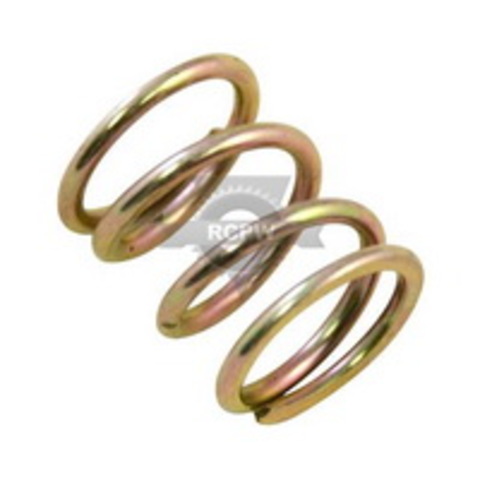

psalms83:18 174 #14 Posted December 18, 2015 Anybody got pics of that spring?? Share this post Link to post Share on other sites
rmaynard 17,612 #15 Posted December 18, 2015 (edited) 52 minutes ago, psalms83:18 said: Anybody got pics of that spring?? It can also be found under the seat on 300 series models. Edited December 18, 2015 by rmaynard 1 Share this post Link to post Share on other sites
