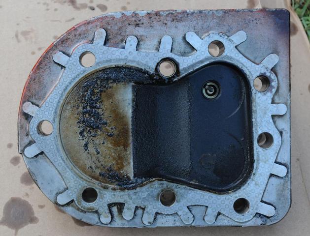

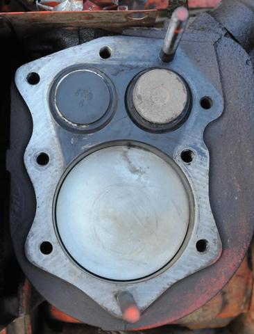

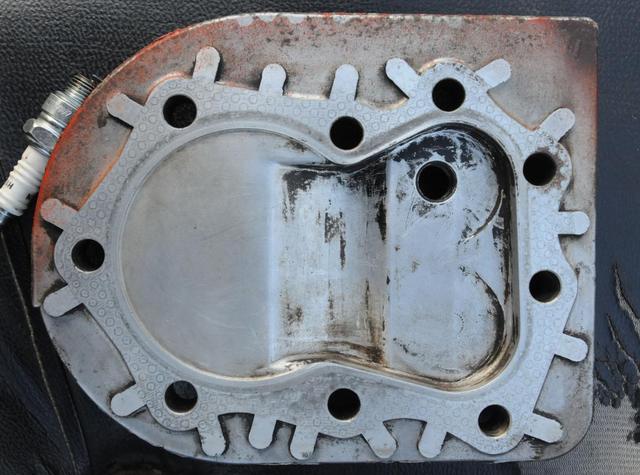

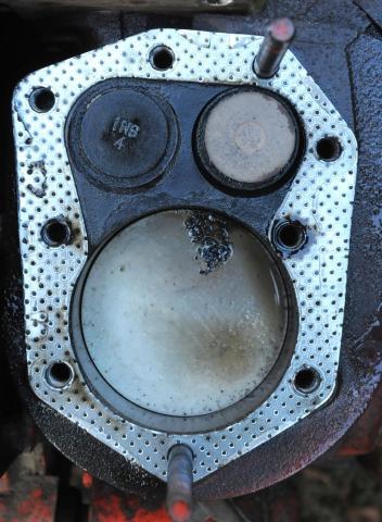

tomtractor 71 #20 Posted November 19, 2012 I hope to rectify the tapping/knocking sound with a head cleaning. What do you all think. I removed the head, clean carbon and plan on replacing new head gasket. Any feedback??? There is no more carbon chunk. It does not appear to be a STD piston. Share this post Link to post Share on other sites
1054josh 25 #21 Posted November 19, 2012 In my opinion it looks like you have a lot of piston to cylinder clearance in the bottom of the clean picture. I would also be wondering what the burn look on the valve side of piston is? Looks like might be starting to have a hot spot melting the top land of piston. At this point I think I'd just take it on down to be safe. But again its just my opinion. Share this post Link to post Share on other sites
Duff 206 #22 Posted November 19, 2012 Hi, Tom, What you've done so far looks really good. Be sure to vacuum the area around the piston carefully with a Shop Vac to remove any tiny particles of carbon that may have dropped into the bore between the piston and the wall while you were scraping. Duff :thumbs: Share this post Link to post Share on other sites
Anglo Traction 761 #23 Posted November 19, 2012 Hi Tom, I'm no Veteran Kohler Engine Re-Builder, I've done 3 so far. From what I see in your pics, The knock/noises will not be cured with just a Top end clean. There appears to be a lot of Oil Wash on the piston top. This is where the oil passes the Rings and cleans the Carbon off. There should be an even coating of Carbon all over the Piston surface (like the rest of the Valve/Seat area). However, you say it does not burn oil (no smoke), so not sure what condition your Rings/Piston fit are like. I reckon the only way to work out what is going on , is to pull the Oil Pan and check inside. Your Piston does not look standard Kohler, the ones I've pulled have a dimple in the top centre from the machining process, so someone may have been in there in the past. From what I can see, the Cylinder Bore walls look clean with no scoring or wear lip near the top. May be best to give it a full health check, it will put your mind at rest and it will give you long service. Regards Share this post Link to post Share on other sites
tomtractor 71 #24 Posted November 19, 2012 The discoloration on the piston is carbon/sludge i didn't fully clean off. I didn't know how much scrubbing/scraping is good. Share this post Link to post Share on other sites
