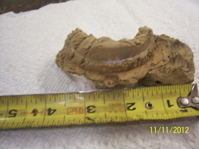

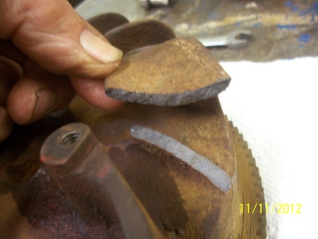

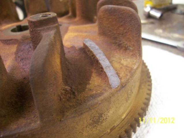

rockinhorse 45 #1 Posted November 11, 2012 I found a large mud dobber nest behind flywheel. Had pullers on and give a little tap with punch and the rest is history . Flywheel poped off hit the rags and carpet on floor thought everything was OK. WRONG broke a fin off i know this is not good but how bad is it. Will i have to replace flywheel? Here are some pics of damage and the nest i was going for , how do they get in some of the places they do? Give me some ideas on what to do. If i have to replace does anybody have one? Thanks Karl Share this post Link to post Share on other sites

Tap53 57 #5 Posted November 12, 2012 just break off other fin directly opposite, will put back in balance and not have any effect on anything.. also, its a very easy brazing job with alittle pre-heating. 1 Share this post Link to post Share on other sites
wheelhorse656 20 #6 Posted November 12, 2012 Break one off on the other side.... Clean it really well and inspect it closely and you keep it and use it.... I have a few flywheels I would sell if you want one that's not broken..... But please please please make sure thier is no cracks or fractures before you reinstall the one you have..... 2 Share this post Link to post Share on other sites

VinsRJ 725 #11 Posted November 13, 2012 One fin is not going to throw the balance off that much, it looks to be a clean break and it doesn't sound as if the flywheel fell off the Empire State biulding. So long as there are no cracks or stress fractures in the key way it can be re-used. 1 Share this post Link to post Share on other sites
AMC RULES 37,261 #12 Posted November 13, 2012 I would think you would need to have it magnafluxed to confirm whether it's a time bomb or not. Share this post Link to post Share on other sites

tarcoleo 120 #14 Posted November 13, 2012 The piece your holding does not appear to fit the stub where it supposedly broke off. Welding, therefore, would seem be a problem. Recommend you inspect the wheel carefully, cut off an opposite fin and check the balance if you can imagine a way to do it. Use it if you must until it can be replaced ASAP. Tom in RI Share this post Link to post Share on other sites

Save Old Iron 1,576 #20 Posted November 14, 2012 Karl, the folks who have never experienced a catastrophic failure of a high speed assembly like a flywheel or a clutch may be of the opinion "no biggie, weld, glue or snap off the opposite fin". Those who have experienced or witnessed such failures will be understandably steadfast to the philosophy of "replaced it at all costs." There is also middle ground that has been expressed here too. Have the part taken to a machine shop, checked for cracks and have the broken fin and the opposite fin MACHINED off (not broken off) and a quick check of static or even dynamic balance and you have a useable flywheel, You will be paying out $$$ for this precision work. I agree with the replacement philosophy and the safety factor that affords you and your family. You would probably never think of pointing the outlet of your mower toward your family while your mower is running over a gravel driveway - please don't think that a flywheel exploding would be any less a danger to your family or friends. The key here is understanding. Understanding (and sometimes experience with) the forces involved in a chunk of cast iron leaving the engine area at speeds well over 100mph. Also, check out Google or YouTube for a brief introduction to the MagnaFlux process. Once you understand how a small crack in cast iron (most often undetectable by the naked human eye) can ruin your day, you will also understand what must be done. Live long and prosper. 5 Share this post Link to post Share on other sites
