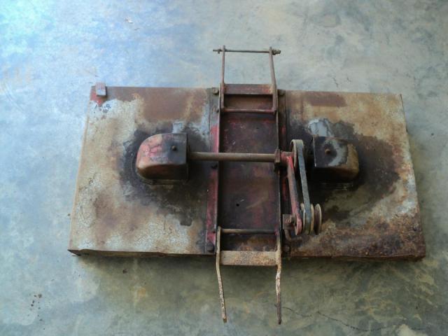

KEN NABER 28 #1 Posted November 9, 2012 Guys and Gals my new toy (1960 Suburban 400) is missing lift parts (see pic on left). just got this grass attachment any pics on lift parts greatly appreciated. Any info on attachment appreciated also. thanks Ken Share this post Link to post Share on other sites
CasualObserver 3,406 #2 Posted November 9, 2012 You're deck is the 1960 version of the RMR-32. It is missing the lift rod, slot hitch bracket and engagement pedal (unless its still on your tractor's right foot peg) (and belt cover... but those are always missing.) You can get the lift rod dimensions by looking here.... The slot hitch bracket is just a bent piece of flat stock with a tab welded on for the rod to go through. Share this post Link to post Share on other sites
