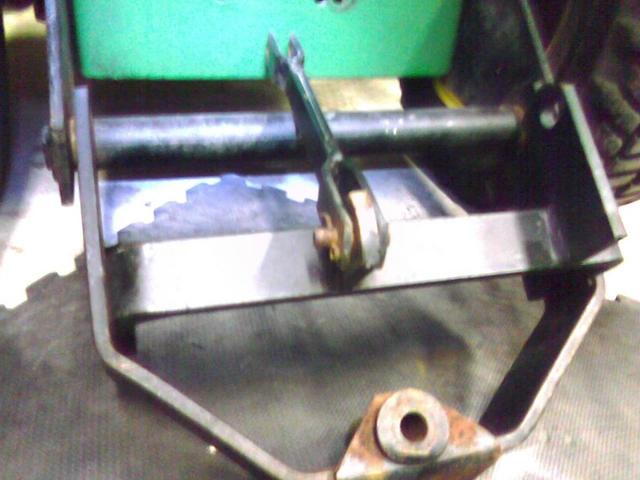

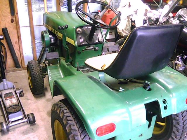

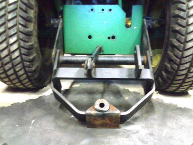

Wheel-N-It 2,978 #1 Posted November 9, 2012 Hey Guys. After work today I went to a friends house and bought a Brinley hitch setup for one of the Wheel Horses, and another Brinley hitch setup for my 1969 John Deere 140H3. OK here is my problem and question; The JD hitch clips on nicely to the frame, so all good there. But, there is two linkage arms that connect to something that raises and lowers the part of the hitch that connects to the implement. Obviously I need another thingy. Can someone here please telll me what that is, and where it connects to the tractor? A pic sure would help if thats not too much to ask. Also if I have to buy a part, do any of you have one to sell me? Here are some pics of what I have. Thank you for any assistance you can offer. Van Share this post Link to post Share on other sites

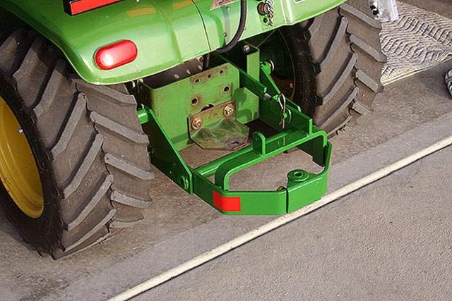

T-Mo-(Moderator) 4,904 #2 Posted November 9, 2012 The integral hitch (John Deere's term for sleeve hitch) was made to fit both the closed frame hydro tractors, like your 140, and also the square fender 110/112 and the 200 series gear drives. The lift link that's on your hitch is for the gear drives. The lift link or arm for the hydros was longer. It hooks to the second tab on the hitch and runs to the tractors rockshaft through the notch in the frame shown in your picture. You can easily make one - here is some plans that shows the arm you need: http://www.wfmfiles....of_20081016.pdff You can find a lot more info by going to Weekend Freedom Machines http://www.weekendfreedommachines.com Share this post Link to post Share on other sites
T-Mo-(Moderator) 4,904 #3 Posted November 9, 2012 Oh, here is a pic of what it would like on the back of your 140: Share this post Link to post Share on other sites
