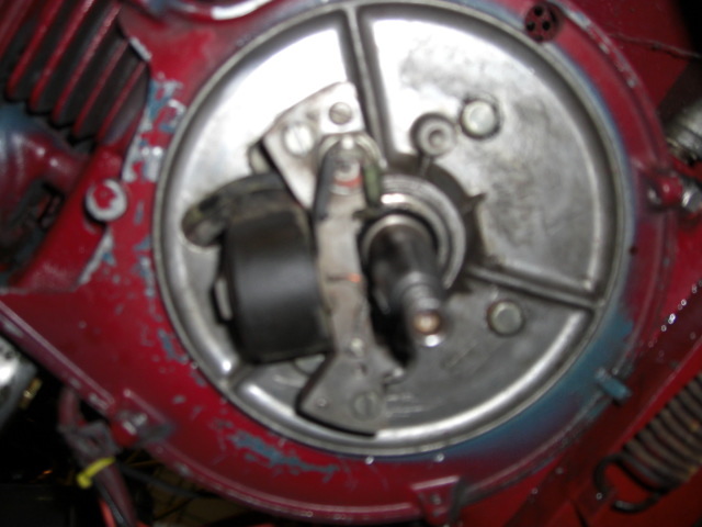

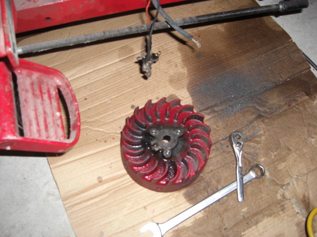

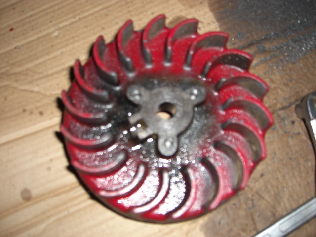

KEN NABER 28 #11 Posted November 9, 2012 Guys and Gals well, got it off, as you may notice I drilled 3 holes and threaded them for 5/16 course and used a puller no heat. Now, where does the condenssor go? This is my first time with a suburban K91. Ken Share this post Link to post Share on other sites
Terry M-(Moderator) 2,329 #12 Posted November 9, 2012 I usually tap in 2 large screwdrivers under the flywheel 180 degrees apart to wedge it out a little and then hit the loose nut with a brass hammer. Some are more stubborn than others so it may take a few hits. I've done it that but with two flat wonder bars instead of screw drivers. then a mild couple of hits on the loose flywheel nut and usually it will pop off with no problem. never yet had a flywheel I couldn't get off. Share this post Link to post Share on other sites

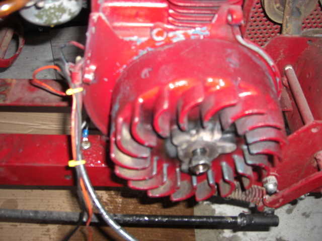

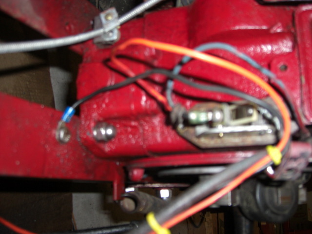

groundhog47 448 #13 Posted November 9, 2012 Guys and Gals well, got it off, as you may notice I drilled 3 holes and threaded them for 5/16 course and used a puller no heat. Now, where does the condenssor go? This is my first time with a suburban K91. Ken Not sure if that's points in photo 4 and 5, can't maginfy, but if so and a 2 wire junction at points trace wires. It appears blue comes from mag coil so red/orange? must go to condenser. At any rate the coil has a wire to points and condenser, on mine it terminates at condenser first and then junctions off to terminate at points. Either way it's electrically the same. Shoulb be a condenser with little flat metral protrusion and screw at on end. Hope not to steer ya wrong again. And again that red/orange may be "kill" wire. I'll continue lookin. Share this post Link to post Share on other sites
groundhog47 448 #14 Posted November 9, 2012 Does your point cover have a kill button on it. Found picture of mag in Kohler repair manual showing a single wire comin' from coil with an eyelet that goes to points and bridges off that to an open eyelet for condenser, sorta like mine (mag K-241), bet mine is bass ackwards! In picture 3 showing mag coil and retainer (in post # 11) something appears attached (if coil at 260 degrees) at 350 degrees that looks lika a wire with terminal end. Now I wanna know was this engine runnin' when ya got it, and are points SEVERLY pitted, course am probably talkin' to a mechanic anyway so no scarcasm or upidyness intended mechanic or lay person, but ya really got my curiosity up! Share this post Link to post Share on other sites
KEN NABER 28 #15 Posted November 9, 2012 Gerry no, it did not run, am workin in the dark. I really appreciate comments, not a mechanic myself, knew points need a condener, thought it might be behind flywheel with coil, kinda crazy to think that, point cover missing, tried to test coil with multi meter, then just got new one. guess i will get a condenser form ebay and put it in line, just got a cover for points off ebay for 7 bucks no kill button on that one, none on my c-141. Ken Share this post Link to post Share on other sites

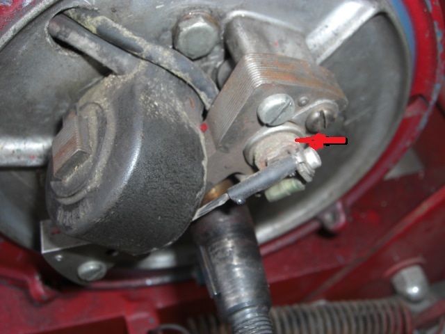

groundhog47 448 #16 Posted November 9, 2012 Gerry no, it did not run, am workin in the dark. I really appreciate comments, not a mechanic myself, knew points need a condener, thought it might be behind flywheel with coil, kinda crazy to think that, point cover missing, tried to test coil with multi meter, then just got new one. guess i will get a condenser form ebay and put it in line, just got a cover for points off ebay for 7 bucks no kill button on that one, none on my c-141. Ken Sounds like ya have it aimed in right direction. AND you are right acordin' to what I read some older models had condenser behind flywheel, wish I could find that pic. again. Only motors I presume that had "kill" button on cover (like mine) were off equipment you didn't stay real close to I guess. This attached photo shows good silver condenser on wood, red condenser is off K-301s (with wire lead to coil)You may see dangling bridge wire off bottom off point box where condenser terminates and may see red "kill" button. This is not from a WH. Have a better Day Share this post Link to post Share on other sites

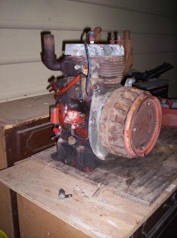

KEN NABER 28 #17 Posted November 9, 2012 Gerry here it is Thanks Ken 1 Share this post Link to post Share on other sites
groundhog47 448 #18 Posted November 10, 2012 Be danged, have seen that type condenser before and wondered why such a strangebracket, whoda thunkit. I know you are relieved. Good job , are ya gonna leave a new one there or "insulate off" the old lug and reterminate outside of the "dungeon" it was hid within? Share this post Link to post Share on other sites
