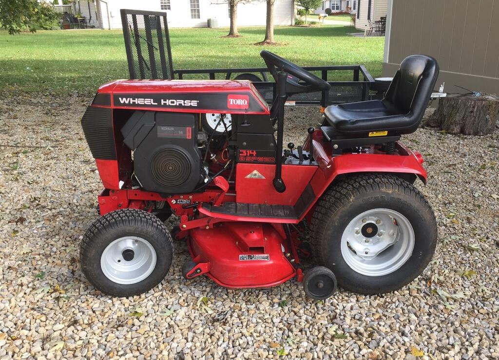

cschannuth 3,821 #16 Posted March 21, 2021 I’m used to mowing with a 520 with a 48” deck. It mowed smooth as glass at full speed. I picked up a like new condition 2000 314-8 with 275 hours and a 42” deck a couple years ago. It cut nice but I had to use first gear in high range to obtain good cutting results. It surprised me since it runs perfect and the deck amd blades looks like new also. 1 Share this post Link to post Share on other sites

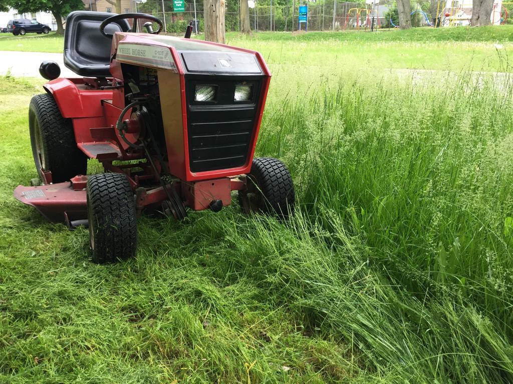

SylvanLakeWH 32,702 #17 Posted March 21, 2021 My 10 hp ran through this in 1st gear high... 1 Share this post Link to post Share on other sites
