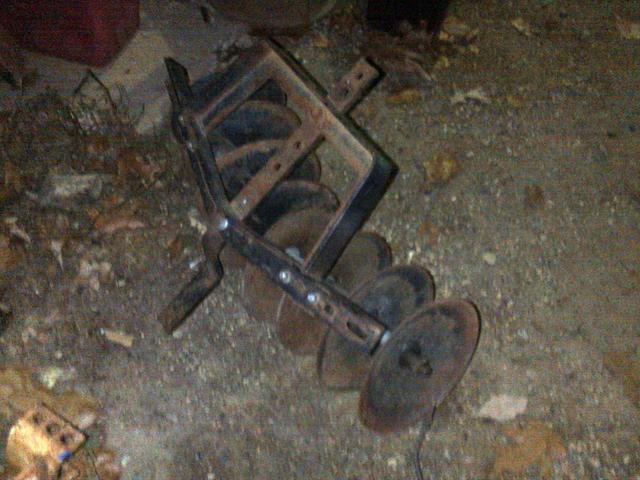

pumper.atv 26 #1 Posted November 2, 2012 just bought a brinly disk and i am curious how the hitch attaches thanks :thanks: Share this post Link to post Share on other sites
kpinnc 18,911 #2 Posted November 2, 2012 You might be able to use the older-style slot hitch with that. See this thread if you don't have one: The "s"-shaped bent tang on the back of your disk is for connecting a second gang. The straight one is where you hook up to the tractor. Share this post Link to post Share on other sites
CasualObserver 3,416 #3 Posted November 2, 2012 Looks like you're missing the other "s" part that bolts to the tongue to go on the clevis hitch. You could probably bend and drill one pretty easy. (or have it done) I think the jaw has to be 3½ inches... but you need to double check that. I don't have a brinly clevis handy to measure. Otherwise, like Kevin said, you can probably use it with a slot hitch.... but I'd still bolt an extension on it. Share this post Link to post Share on other sites
Don1977 606 #4 Posted November 2, 2012 You can use 2 pieces of 2" x 3" x 1/4" angle iron 4" long. Drill the 3" sides with matching 3/4" holes then weld the 2" side together to form a "C" . Then weld a piece of flat iron to that the bolt up to you disk. Share this post Link to post Share on other sites
dtallon 320 #5 Posted November 2, 2012 I just used mine with my 854 last weekend to smooth out the garden after I plowed it. As others have stated, you are missing a piece if you want to hook to a Brinly sleeve hitch. Fortunately for a Wheel Horse, you can just reverse the center bar for use with a slot hitch. 1 Share this post Link to post Share on other sites
pumper.atv 26 #6 Posted November 3, 2012 Thanks guys i was thinking that i just needed another piece that was bent but i wanted to verify :thanks: Share this post Link to post Share on other sites
