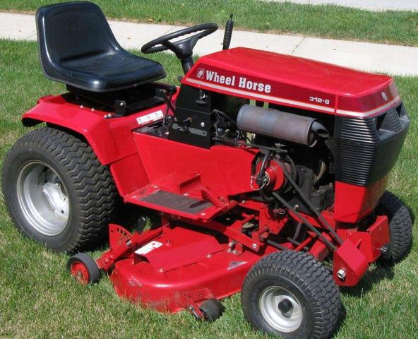

sadixon49 11 #1 Posted October 30, 2012 Is there any difference between slot hitches off of different models? I'm looking to get a slot hitch for my 312-8 to mount a rear blade for snow removal. I've seen several on ebay off of different machines, I think they are all the same, but thought I would ask here first before I do something stupid. Also what would be needed to hook it up? I know it uses a cable assy from the lift arm back to the hitch, anything else needed? steve Share this post Link to post Share on other sites
