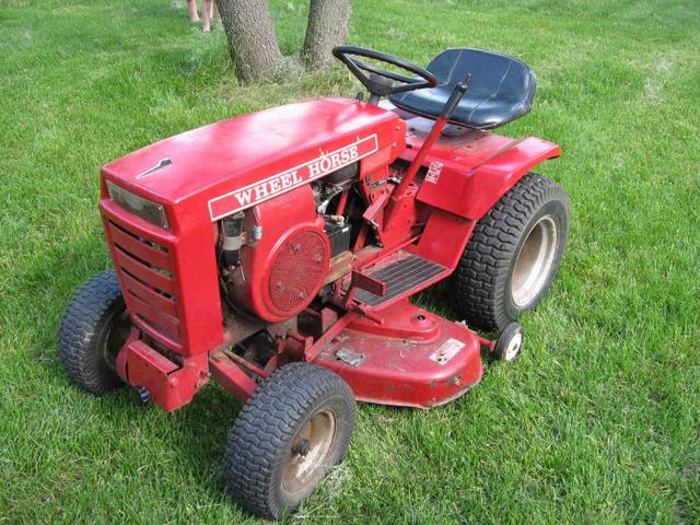

ranscobia 0 #1 Posted October 21, 2012 My 12 year old son is a proud new owner of a 1974 C100. 8 speed gear transmission. This tractor was given to him to be a project. I need to replace the axle and brake seals. My question is can the seals be replaced without splitting the trany? Also what oil is used in the trany and what is the capacity? Thanks, Randy Share this post Link to post Share on other sites
Trouty56 568 #2 Posted October 21, 2012 Those seals can be replaced without opening up the tranny. If they are leaking bad chances are the hubs are loosened up so they will pull off easy. They can be a bear sometimes....most of the time. Check the axle for side to side play. Here's a manual from the files area.... There are lots of topics on this procedure. The search at the top should get you some information..... Welcome to the site!! http://www.wheelhors...manual-rev-482/ Share this post Link to post Share on other sites
rmaynard 17,219 #3 Posted October 21, 2012 2 quarts of SAE 90-140 A.P.I. Service GL-5 Gear Lubricant. Great looking project tractor. Share this post Link to post Share on other sites
ranscobia 0 #4 Posted October 21, 2012 Thanks for the info and manual link. I will get the correct oil and change it out. I may have to open trany up anyway, looks like water has gotten in (probably thru the gear shift lever). Next step will be to get the charging/electrical system working. I have good voltage from the stator to the Reg. and 0vdc out on the r+ term. I found an after market Regulator for $40.00 should have it next week sometime. Thanks again Share this post Link to post Share on other sites
whc160 80 #5 Posted October 21, 2012 Here is a link to how I replace the seals & fix the loose hubs. I had water in one of my trans. I drained the oil for two days. Then filled the trans with diesel fuel & drove it around for 10 min. Let drain for two more days & filled with new oil. Depending on how bad it is you may have to flush the trans two times to get it all out. The C's are great workers & I hope your son enjoys it as much as I enjoy mine. Share this post Link to post Share on other sites
Trouty56 568 #6 Posted October 22, 2012 Make sure that rectifier is grounded good...... Share this post Link to post Share on other sites
ranscobia 0 #7 Posted October 22, 2012 I was thinking about adding a ground wire so I do not have to rely on the mounting hardware. Maybe carefully drill and tap a fin with an 8/32 machine screw. Share this post Link to post Share on other sites
