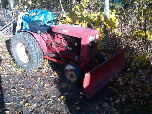

post-8621-0-99341000-1350840793_thumb.jp No replies so I bought it. Proud new papa of a 1054 saved from scrapyard.... Paid $150. picture does not show belt guard and previous owner took off origional engine ???? but gave it to me intact. A box of parts including the side shield were turned over looks as though I have everything.

Have GT14 and yours is early version they say. Mine can pull gas tank easiest by removing the grill and tank as a unit. Looks like same grill on those, not sure on the tanks. I would like to try one of those next. Just my kinda price too! Wanna sell that blade? Seems they have a little diff one on those and GT14's. Hey, stand out of the sun next picture shot, no shadows! Ha! Take a few more, I like pix. Get shot of steering wheel and seat, both up and down, want to compare to what I need go find for mine. 14's are diff than most B and C models, maybe yours is same?

Picture was as it sat where I bought it. Will take more pics soon, I couldn't wait to tear her down. Man came over today to look and make copies of decals for making new ones. He said all graphics would be about $50.00, thought that was good. Seat on it is the only thing not origional so I don't think it would help you. I will take some steering wheel and dash shots for you before I get that I taken apart.

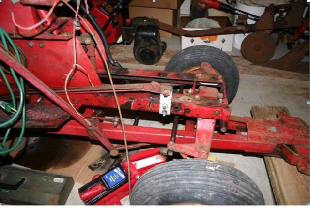

1.bmp post-8621-0-84547300-1351087635.jpg Well here I go, start of rebuild.
