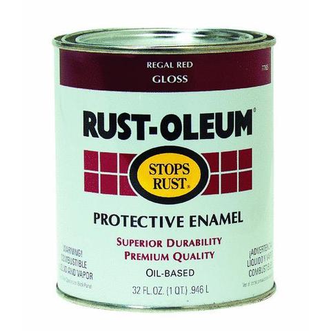

1maidenfan 203 #1 Posted October 20, 2012 Was wondering if this is the type of paint that some of you buy to paint your tractors? Thanks Share this post Link to post Share on other sites
KC9KAS 4,746 #2 Posted October 20, 2012 That is what I use in spray cans, and if and when I paint with a cup & compressor, that WILL be the paint I use. 1 Share this post Link to post Share on other sites
Forest Road 595 #3 Posted October 20, 2012 I like Rustoleum farm paint on IH red. Quarts and spray cans are redily available. Share this post Link to post Share on other sites
Zeek 2,314 #4 Posted October 20, 2012 I happen to be trying the same thing right now. So far I like it. Stay away from TSC Majic . . 1 Share this post Link to post Share on other sites
1maidenfan 203 #5 Posted October 20, 2012 Thanks for the replys, I am currently using the regal red in the rattle can but was wanting to try with a gun. Wanted to make sure I purchased the correct stuff. Thanks guys. :woohoo: Share this post Link to post Share on other sites
mattd860 163 #6 Posted October 20, 2012 I mix regal red quart cans with 50% acetone and spray it with a hvlp gun. The finish is fantastic. 2 Share this post Link to post Share on other sites

welderman85 53 #9 Posted October 20, 2012 i have used the rustoluem with good results. looks good and holds up pretty good Share this post Link to post Share on other sites

mattd860 163 #11 Posted October 21, 2012 I mix regal red quart cans with 50% acetone and spray it with a hvlp gun. The finish is fantastic. Do you have link to any pictures? I mix regal red quart cans with 50% acetone and spray it with a hvlp gun. The finish is fantastic. If you mixed up more than you needed would it keep until another time? I don't really know to be honest. I do know that if you add hardener it won't last more than 8hrs. But I don't know how long it will last if you only add acetone. To be safe, you should just mix what you plan on spraying immediately after. Share this post Link to post Share on other sites
CTPhil 53 #12 Posted October 21, 2012 Did you use hardener? Does it work OK without? Your tractor looks great! Share this post Link to post Share on other sites
mattd860 163 #13 Posted October 21, 2012 Did you use hardener? Does it work OK without? Your tractor looks great! I used Valspar hardener (http://www.amazon.com/Valspar-Oz-Enamel-Hardener-18-4625/dp/B003WL8BO6/ref=sr_1_3?ie=UTF8&qid=1350842707&sr=8-3&keywords=valspar+hardener). I have never sprayed without a hardener so I don't know how it will work without it. Share this post Link to post Share on other sites
CTPhil 53 #14 Posted October 21, 2012 Thanks! I think I need to up my game. I painted a Gravely L8 with Rustoleum and it turned out well, but took weeks to really harden up, Lots of paint damage during assembly. Share this post Link to post Share on other sites
KC9KAS 4,746 #15 Posted October 21, 2012 Thanks! I think I need to up my game. I painted a Gravely L8 with Rustoleum and it turned out well, but took weeks to really harden up, Lots of paint damage during assembly. I think the addition of hardener will take care of this problem. Share this post Link to post Share on other sites
mattd860 163 #16 Posted October 22, 2012 Thanks! I think I need to up my game. I painted a Gravely L8 with Rustoleum and it turned out well, but took weeks to really harden up, Lots of paint damage during assembly. Even with the acetone and hardener, the rustoleum paint will need at least 5-7 days to cure/harden. It can be handled after 8hrs and wet sanded after 24hrs (maybe earlier if the climate is dry and warm). Share this post Link to post Share on other sites
Wishin4a416 2,610 #17 Posted October 22, 2012 What brand or type of hardener do you use with Rustoleum? Share this post Link to post Share on other sites
mattd860 163 #18 Posted October 22, 2012 What brand or type of hardener do you use with Rustoleum? http://www.amazon.com/Valspar-Oz-Enamel-Hardener-18-4625/dp/B003WL8BO6/ref=sr_1_3?ie=UTF8&qid=1350842707&sr=8-3&keywords=valspar+hardener Share this post Link to post Share on other sites
Wishin4a416 2,610 #19 Posted October 23, 2012 Thank You. I have hardener for automotive acrylic enamel but didnt think it would work with regular enamel. Share this post Link to post Share on other sites
WHEEL HORSE BILL 7 #20 Posted October 29, 2012 I use that regal red and love it. True paint no acetone or hardener and it works awesome. good luck hope you like it. Share this post Link to post Share on other sites

wheelhorse656 20 #22 Posted October 29, 2012 Regal red sunrise red 50/50 makes. Great color!! MatchesIH red almost perfectly! Share this post Link to post Share on other sites
CTPhil 53 #23 Posted October 29, 2012 A nice thing for me is that regal red is also a near perfect match for old Gravely walk behinds, and also 1980's up. One color for everything! Share this post Link to post Share on other sites
