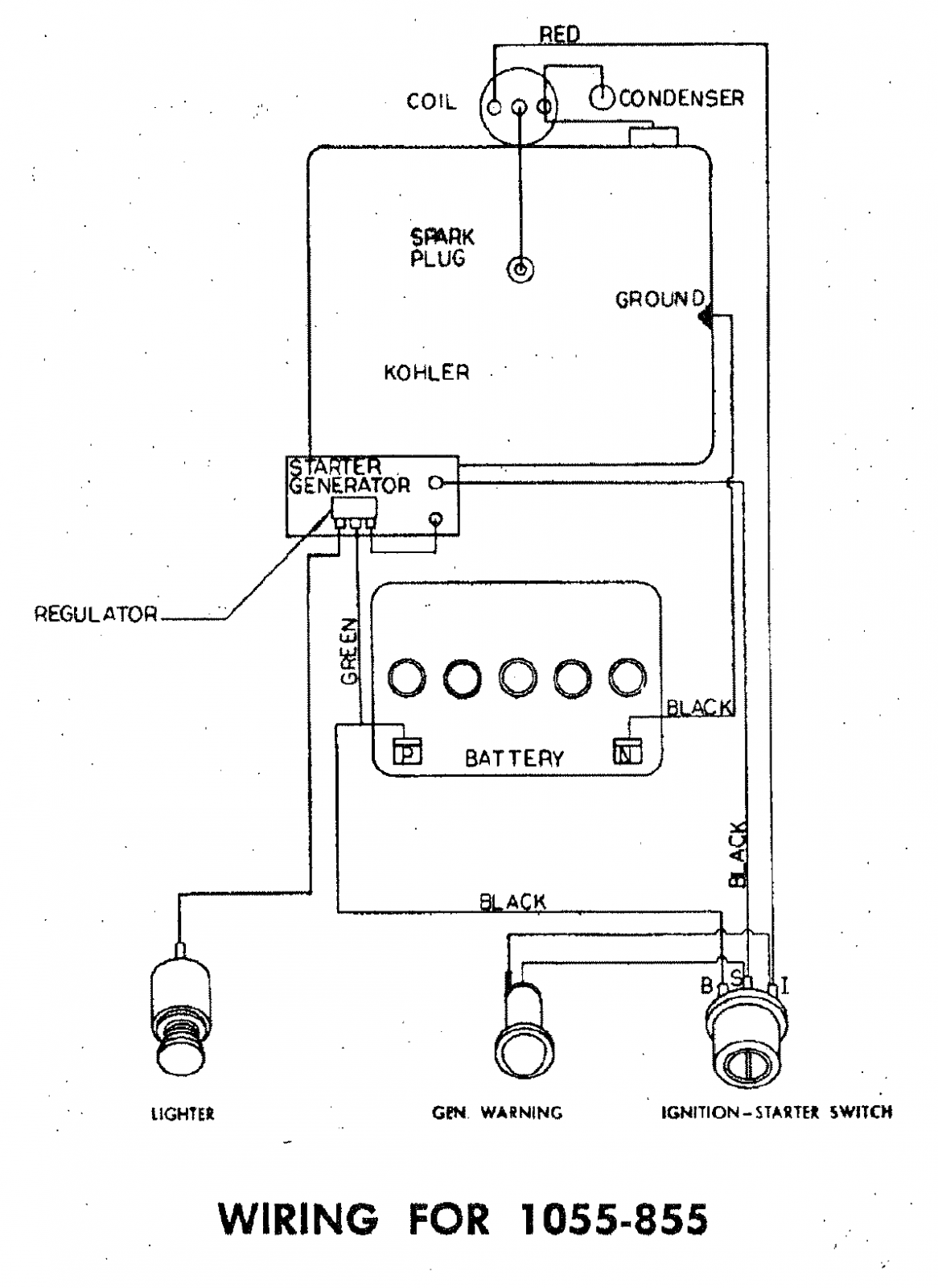

Killer 2000 Chevy 83 #1 Posted October 18, 2012 I have been working on an 855 and I have had the engine apart for a while and I can't quite tell from the pics i took where they go and need to figure out where the wires go off the generator and the key switch. If anyone has a diagram for this I would greatly appreciate it. Thanks red square. Share this post Link to post Share on other sites
rmaynard 17,495 #2 Posted October 18, 2012 Here it is: Share this post Link to post Share on other sites
Killer 2000 Chevy 83 #3 Posted October 21, 2012 thanks it's a huge help I know it's a simple one but it has to be right Share this post Link to post Share on other sites
