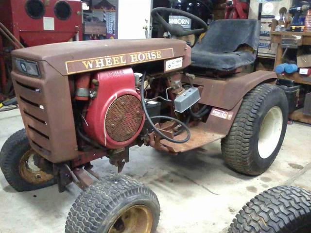

Dieselcowboy 211 #19 Posted October 18, 2012 Here's a pic . And I did get it to start with the carb cleaner then running on gas now. Has make shift gas tank just to get it to run. Share this post Link to post Share on other sites
Kelly 1,038 #20 Posted October 18, 2012 Glad to hear it started for you. Share this post Link to post Share on other sites
