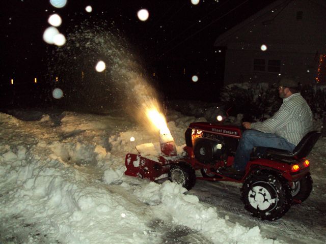

leeave96 496 #13 Posted October 11, 2012 Hank!!!!!!!!!! Very nice work with the snow blade, but you got to get yourself a snowblower for that tractor!!! Here's mine in action: Share this post Link to post Share on other sites

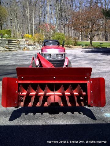

HankB 28 #15 Posted October 12, 2012 ... but you got to get yourself a snowblower for that tractor!!! Like this? I had a chance to put it to some use last year but we didn't get much snow so the blade pretty much covered my needs. Share this post Link to post Share on other sites
leeave96 496 #16 Posted October 12, 2012 Hank - THAT'S IT!!!!!!! Share this post Link to post Share on other sites
dsholler 54 #17 Posted October 12, 2012 Going to try this year with just a blower. I am new to this whole tractor business, but I am guessing that I will probably need a plow to deal with the slushy stuff we usually get here in southern CT. However, I think I need to prove that before I can justify having another large red object in the garage to my wife. Share this post Link to post Share on other sites
