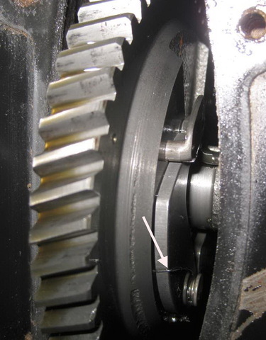

I started to open things and it looks like I can get a partial view of the ACR mechanism. What should I be looking for?
Thanks
Francis
rmaynard
That little hair spring that you are looking at keeps those arms from swinging out until the engine is running at approximately 600 rpm. As pictured, the ACR looks fine.

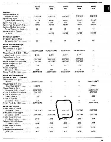

Remember I said that per the Kohler manual the exhaust tappet was "tight", well I started the engine and it started just fine but there was a lot of tapping going on????
Look at the scanned in page that says .018" for the exhaust tappet; do I need stronger glasses, is it a misprint or does some one know the correct setting?
post-2413-0-73855400-1349734889_thumb.jp
rmaynard
Francis,
.018 is the correct cold setting. I would go back and check the settings again if you think you may have set it wrong.

Use steel feeler gauges to set the valve clearances. For the 10-16hp engines, for ordinary yard use, the valve clearances are: .008"-.010" for the intake and .017"-.019" for the exhaust with the piston at TDC on the compression stroke. This is when both valves are fully closed. For competitive pulling, set the valve clearances at .010" for the intake and .014" for the exhaust.
